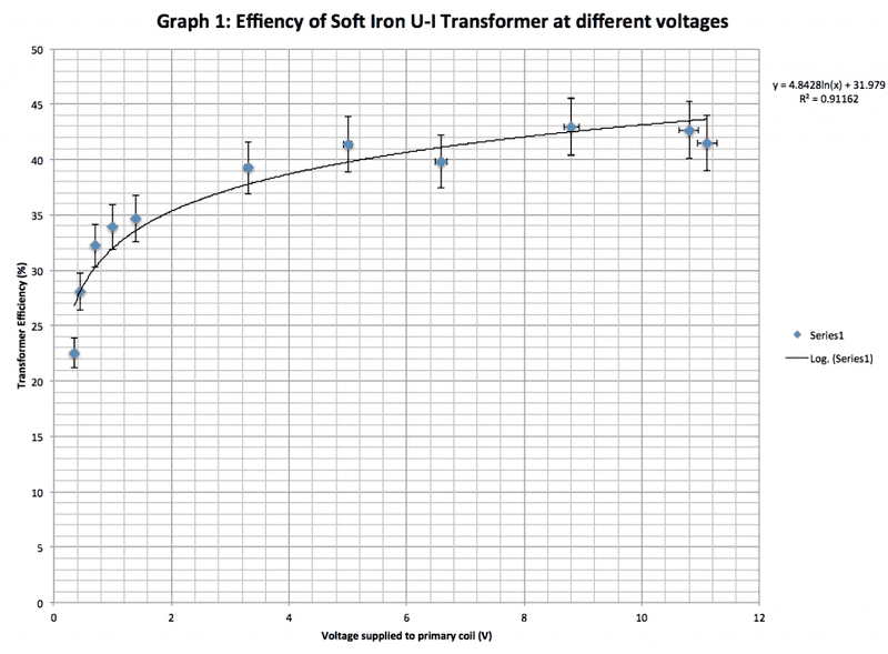

Why the efficiency of air core transformer changes (up and down)
This discussion revolves around the efficiency variations of an air core transformer at different voltage levels. Participants explore the reasons behind the observed efficiency patterns, particularly the fluctuations at specific voltage points, and seek detailed scientific explanations for these phenomena.
  • One participant notes that the efficiency of the air core transformer is high at low voltages but decreases due to high magnetizing current causing heat loss.
  • Another participant questions the accuracy of a specific data point indicating high efficiency, suggesting it may be an outlier.
  • Several participants express confusion over the "bouncing ball" pattern in the efficiency graph, seeking to understand the underlying reasons for these fluctuations.
  • Concerns are raised about the adequacy of data points for curve fitting, with suggestions that the observed pattern may result from insufficient data.
  • One participant proposes that the observed efficiency groups could indicate different experimental setups or measurement uncertainties.
  • Questions are raised regarding the turns ratio of the transformer and the method of measuring secondary current, with requests for clarification on the experimental setup.
  • Another participant suggests that electromagnetic interference (EMI) may have affected the measurements, advocating for a different approach to data collection.
  • Participants discuss the physical arrangement of the coils and the potential impact of coil positioning on the results.
Participants express varying opinions regarding the accuracy of the data and the reasons behind the efficiency fluctuations. There is no consensus on the underlying causes of the observed patterns, and multiple competing views remain regarding the interpretation of the results.
Limitations include potential measurement uncertainties, the adequacy of data points for analysis, and the influence of external factors such as EMI on the results. The discussion highlights the complexity of the experimental setup and the need for further clarification on specific methodologies used.

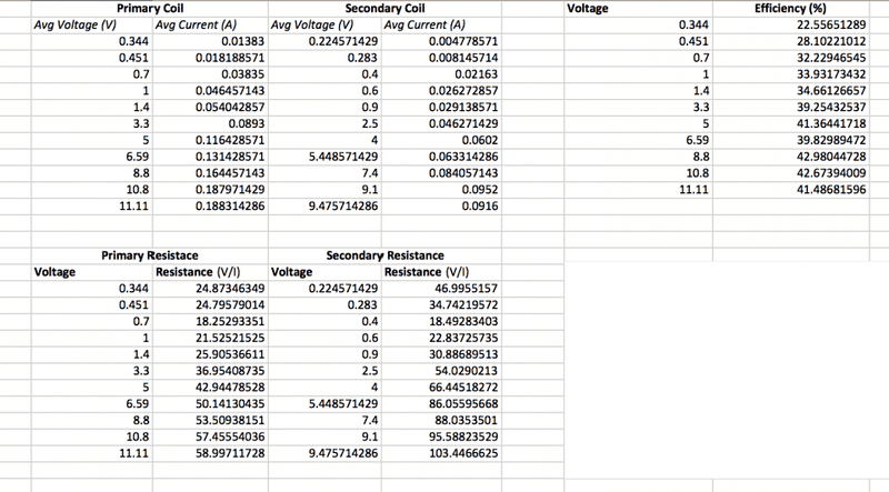

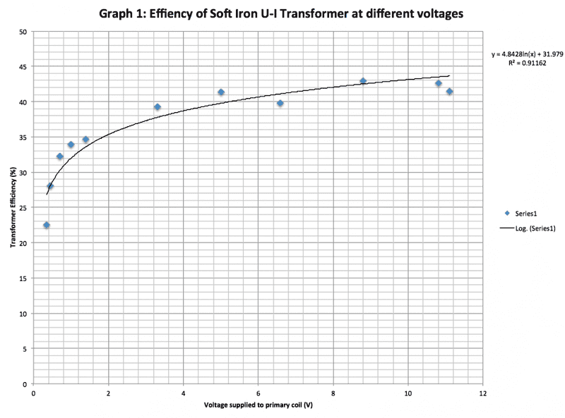

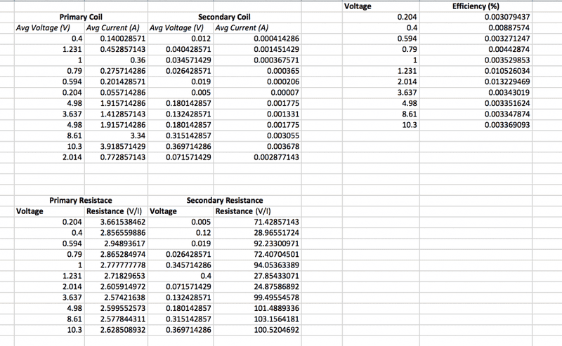

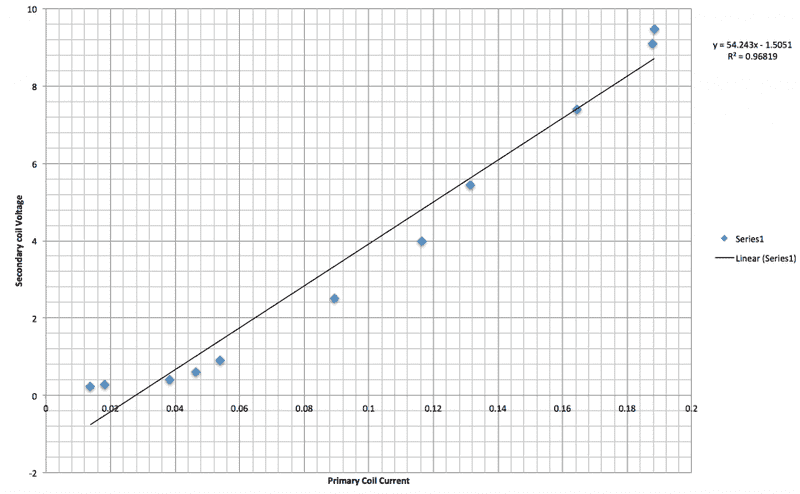

Oh my god, I am really embarrassed by my mistake.
Baluncore said:
Looking at the graph at the top of post #21, I see three points out of line. For the two points in the top left corner 0.35V and 0.4V, I suspect the decimal point has been misplaced in voltage. If the values are reduced by a factor of ten they become 0.035V and 0.04V which then fall on the line.
The point on the LHS axis should be closer to zero volts which will be in the local EMI noise floor.
So maybe 0.12V is also out by a factor of ten making a corrected voltage reading of 0.012V.
Baluncore, you are absolutely right. It's actually what you predicted.
I am really sorry to everyone because of mistakes. Therefore, I will check all my work before I post all the changed graph.
Thank you to all who have been helping me.

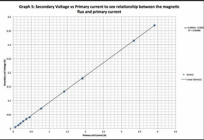

UtsavRaj said:
But the graph i used can be used as a substitute?
Be sure to note that it was somebody else's data.
For studying core saturation It would be better to have secondary open circuit voltage, look how much more current you have.
For studying power transfer it'll be okay

Look at the scatter in your secondary volts vs current plot. Volts divided by current is load resistance. Constant resistance would give a straight line.

I am going to use my data of secondary and primary current.
As soon as i check everything, I will plot it.

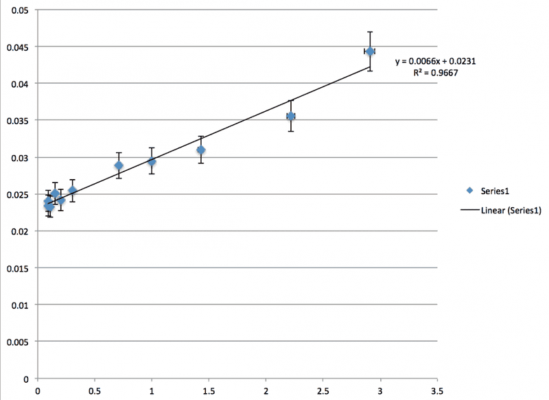

Apart from the 4 outliers we found already, it looks quite linear. We are talking about ~10 µW of power.

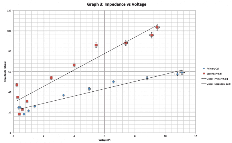

I have not in school but i have been studying articles. But if you don't mind, A simple explanation[of inductance - jh] would be good.
Impedance is the property of a circuit that opposes flow of current.
"Impede" is the memory aid (mnemonic look up that word )
Impedance is measured in Ohms
It is what you get by applying ohm's law Volts = Amps X Ohms
or Ohms = Volts / Amps
1 volt will push 1 amp through 1 ohm
so your transformer's apparent primary side impedance is primary volts divided by primary amps
when you get data squared away plot that, primary volts vertical primary amps horizontal
then plot on same graph a second line of the ratio (primary volts/primary amps) and see if it's a straight line
that second line is primary side impedance

and you will know what is impedance from your Vpri/Ipri ratio plot - what is Zprimary ? ___________ ohms
Next you will take your ohm meter and measure resistance R of your primary coil Rprimary = ___________ ohms
and you will calculate what is X by pythagoras' theorem X = √(Z2 - R2)

Consider the OP's table of primary and secondary voltages. The OP is keeping way too many digits for a lot of his values. I make Baluncore's suggested changes to the first 3 secondary voltages. Then calculate the ratio of primary to secondary voltages for all 12 pairs. It appears that the 6th and last are different enough from 30 that they could reasonably be considered outliers, so I delete them. I'm left with 10 pairs and calculating the ratio of primary to secondary voltage I get these 10 values:
{33.3, 30.8, 28.9, 29.9, 31.3, 27.7, 27.6, 27.7, 27.3, 27.9}
Now subtract 30 from each value, divide by 30 and multiply by 100 to get a percent deviation from 30. I get a list like this:
{11.0%, 2.67%, -3.67%, -.33%, 4.33%, -7.67%, -8.0%, -7.67%, -9.0%, -7.0%}
That's quite a bit of variance. The OP might just barely be able to claim an accuracy of around 10%.
Let's say we applied 1 amp to the primary and expected about 1 volt across it due to IR drop in the primary and 1/30 volt due to inductive reactance.
If the resistive voltage and reactive voltage added arithmetically, we would expect a drop due to 1 amp of 1 + 1/30 or 1.033 volts, compared to just 1 volt due to the resistive drop. Given the variance in the OP's measurements, stray voltages due to placement of his voltmeter leads around the magnetic fields present, and other error sources, I wouldn't bet on his ability to see the difference.
But resistive and reactive voltages don't add like that. They add like SQRT(1^2 + .0333^2) which would give 1.00055 volts. I'm fairly certain the OP can't distinguish that from 1.00000 volts with the equipment and setup he has.

Explanation for trend:
Sudden increase:
  • The induced magnetic field becomes stronger due to permeability of iron core which provides magnetic flux densities 10000 times that of air.high permeability means that the most of magnetic field is concentrated in the iron core and therefore allows a better inductance.n iron core is often used to provide a low-reluctance path for the magnetic flux
  • The resistance of a given piece of wire depends on three factors: the length of the wire, the cross-sectional area of the wire, and the resistivity of the material composing the wire. All of the factors remain the same. Therefore, coil have a steady resistance.
  • Copper losses are low as resistance is the same and the current is low.
  • The iron core Magnetic Stray losses at minimum although it increases with negligible with higher voltage.
  • At this point, the hysteresis and eddy currents are minimal (also because of insulated Iron core).
  • As weak magnetic field produces weak eddy currents and hysteresis.
  • Magnetostriction is low as well
  • Electric hum low due to less magnetic stray.
At higher voltage the increase becomes less.
  • More consistent value:
  • Magnetostriction increases due to a strong magnetic field.
  • Copper losses increases because of increase in current (A big source of energy loss).
  • Eddy Current becomes a bigger problem because of increase in magnetic field that causes bigger current being made in the iron core.
  • Hysterosis also increases. (Don’t exactly know)
  • Magnetic stray loss is still negligible but increases.
  • The induced magnetic field becomes stronger.
  • Electric hum a little bit due to more magnetic stray (which causes friction and therefore energy loss).
Is this explanation of trend right or am i wrong or less somewhere?Some questions i have:
  • Does Hysteresis increases with increase in voltage and current?
  • How does magnetising current affect iron core in efficiency?
  • "To maximize flux linkage with the secondary circuit, an iron core is often used to provide a low-reluctance path for the magnetic flux. The polarity of the windings describes the direction in which the coils were wound onto the core. Polarity determines whether the flux produced by one winding is additive or subtractive with respect to the flux produced by another winding" Can this explain anything about the Iron as well as Air core efficiency?
  • "In lower frequencies (mains) the efficiency is a lot worse, because an air core will have an enormous magnetizing current that will cause losses by heat on the wires." Why high magnetizing current for air core?
As always, thank you for your time.
  • #50
Sudden increase:
This is for the graph above.
  • #51
In your chart check the primary voltage of 6.59 volts. The corresponding primary current appears to be about 10 times too large. Same thing for primary voltage of 11.11 volts. These two points on the graph appear to be outliers.
If you fix those two values your graph will look much better; although the very first two voltage values look questionable too.
  • #52
Why does it have to be a straight line again?
Sorry, the graph is actually this one
