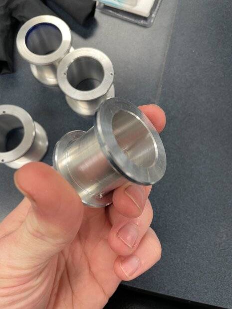

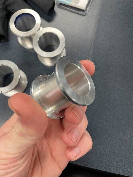

I machined aluminum bobbins to act as a heat sink for the coil, as I'm fairly certain the aluminum shouldn't affect the field at all, although I do have delrin that I could use instead. For the cores, I bought some VIM VAR core iron (99.85-99.9% Fe, less than 0.01% C), machined them to press fit in the bobbins, and had the magnetically annealed in wet hydrogen to homogenize and maximize the relative permeability.

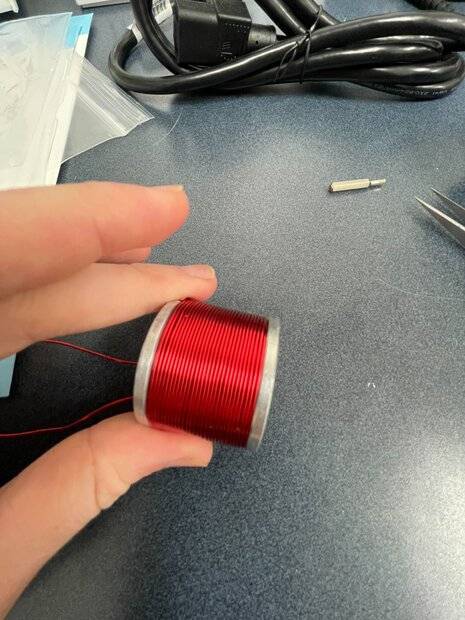

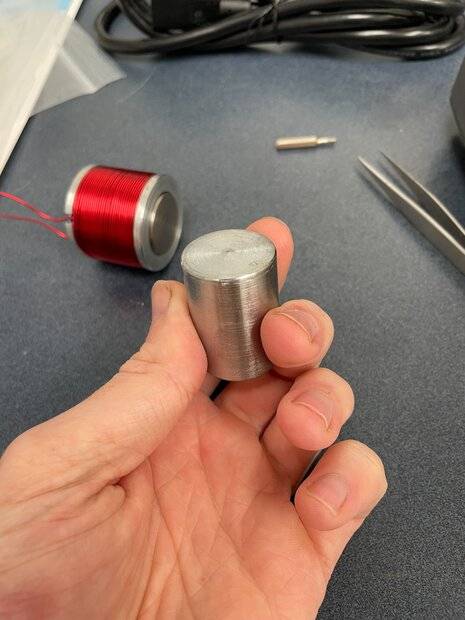

EDIT: Here are images of my current coil that I'm troubleshooting:
Photo of a red-insulated copper coil wound on a grey bobbin, held in a hand, with two loose red lead wires; a pair of tweezers and a small metal rod are on a blue desk behind it.Photo of a hand holding a solid cylindrical iron core, beside a red-insulated copper wire coil on a bench with tweezers and a small metal pin.Photo of a machined stainless steel cylindrical core with a flared flange at one end, held in a hand, with three similar pieces on a dark surface behind it.
It is currently 175 turns of 20AWG enameled magnet wire, but I have different wire gauges and stock to make bobbins from, so I can make more or less turns if needed.

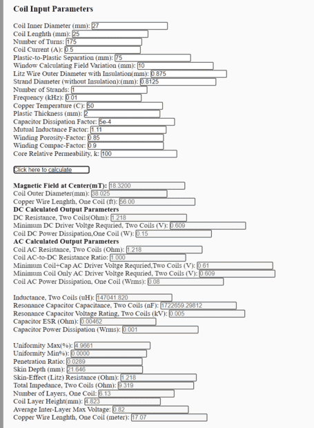

Here is a screenshot of the calculator I've been using to help me. It's called a helmholtz calculator, but it works for any distance to radius ratio as you can input the distance yourself. The link to calculator is https://www.accelinstruments.com/Helmholtz-Coil/Helmholtz-coil-calculator.html
Screenshot of a web-based coil calculator titled Coil Input Parameters, with fields for coil dimensions, turns, current, core permeability and outputs such as magnetic field at center, resistance and inductance.

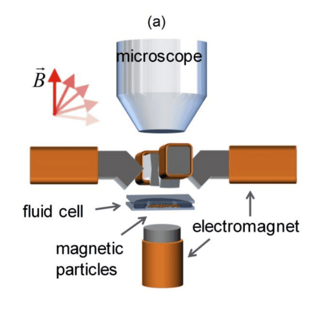

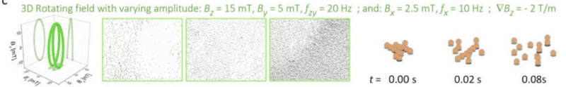

Here are some screenshots from a study I am trying to replicate. They detail the field shape and field strengths, frequencies, as well as the setup they used.
Schematic (a) of a magnetic setup: a microscope objective above a fluid cell with magnetic particles, flanked by two orange electromagnets and one below, with a B vector arrow at upper left.Figure panel c: left, a 3D plot of a rotating field trace with axes Bz, By and Bx in mT; centre, three grainy greyscale images; right, three frames at t = 0.00 s, 0.02 s and 0.08 s showing small orange-capped particles.
The experiment involves an elliptical rotating field out of plane generated by the Z and Y coils, with an additional AC field at a different frequency applied in the X axis.

Can you upload some pictures of the setup? Use the "Attach files" link below the Edit window to do the uploads.
Also, can you upload a sketch of the desired field shape? I'm a little confused when you say "uniform field" but you also have a pole below the microslope slide. What direction(s) do you want the field to point?
Without the bottom pole, I would have assumed that you wanted to be able to switch on either a field in the x-direction or a field in the y-direction, but with another pole below the slide I'm not so sure.

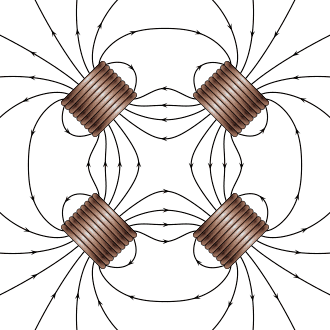

Are you certain this arrangement of magnets will provide a uniform magnetic field? Could you inert some or all of your setup inside a solenoid instead? A quadrupole arrangement typically produces very little field at the very center but rapidly increasing field strength as you move away:
Four cylindrical coils with iron cores arranged in a square, with magnetic field lines looping between and around them, showing a quadrupole field pattern.
Adding a 5th coil underneath probably won't give you the uniform field you want.
These are AC, I am actually trying to replicate a study I read for the first part of my experiment. I've included an image taken from that study, which shows the field shape, frequencies, and field strengths they used. I have also attached some images of my first coil and core, which I've been troubleshooting.

As well, I have attached a screenshot from the calculator I have been using from https://www.accelinstruments.com/Helmholtz-Coil/Helmholtz-coil-calculator.html
The screenshot should show the expected results with even a permeability of 100, much less what I should be actually getting.
I shouldn't have said uniform. Not each pair of coils will be producing the same field. There will be an eliptical AC rotating field produced by the Z and y axis coils (90 degrees out of phase at function generator), and a weaker AC field applied through the x pair of coils. I've attached an image from the study I'm trying to replicate for the first part of my experiment.

The aluminium bobbin transforms into a shorted secondary turn when it is used as an AC coil former.
You need to cut a slot in the bobbin, to break the circular electric conductive path, or switch to a non-conductive bobbin.

Sorry I shouldn't have said uniform, the field shape is not uniform, I simply meant that in each axis, the field would be uniform radially from the center. Each axis of coils are producing different field strengths and frequencies, so the sum field shape is not uniform. The idea is that this specific field shape should help to disaggregate magnetic particles. Check out the picture I posted in another reply for a visualization of the field.

I'm not sure I understand. Why would it short the coil if the wire is enameled? an induced field? Sorry if this is stupid, I guess I just need to learn more. I was able to generate the exact expected field strength with an air core, is this expected even if the bobbin is a problem?
Thanks for the additional details and the diagram; they help some.
The comment by @Baluncore about being careful introducing shorted turns is very important for AC magnetic fields. Please ask for more details if that is not clear. Also, what frequencies are we talking about for the AC component of the excitation?
It's important to start thinking early-on about completing the magnetic path to help to increase the strength of the B-field in the gap volume. If you just have isolated ferrous cores for the coils, that is not a good way to design such a setup. You want the only gap volume to be in the test volume, and all other parts of the magnetic paths are through ferrous metal. The longer the magnetic path length through air, the higher the "Reluctance" along that magnetic path, and the lower the B-field strength that you can create with your drive current.
Finally, you mention a 3" gap length in the microscope slide region, but given your diagram and typical microscopes that I work with, I'd estimate the max gap dimension at closer to 1.5"-2". You want to minimize that distance as well, in order to give you the strongest field from your drive current.

You have unknowingly wound a transformer. The Al bobbin has become the secondary winding.
The solid magnetic core you are inserting into the bobbin will also act as a shorted turn to the primary coil. The core should be laminated, or have an insulated matrix containing iron powder or ferrite.
So you have two shorted turns, both of which must be replaced with bulk non-conductive material.

Sorry, I guess I don't really understand the problem with the aluminum. I could make it instead with delrin (plastic). Frequencies are 10-20Hz, so pretty low.
Are you saying I shouldn't have a bobbin, and just wind directly around the core? Is the 1mm wall thickness of bobbin creating a big problem?
Yes. There is an AC current, induced by transformer action, running in the aluminium.
That would be a good move.

When you say the core should be laminated, are you saying the kind of thin laminates that you find in a transformer to reduce eddy currents? Or that the core should be encased in something non-conductive? Becasue in that case the delrin bobbin would solve both problems
canuck123 said:
Oh. So even if I wound directly around the iron core, it would be bad? I thought winding directly around a core was pretty common, I have seen it done in many places, including the study I am trying to recreate. Why would an insulated matrix of powder be better than a solid iron core? Sorry, this is just very counter-intuitive to me based on the limited stuff I researched.
You need to avoid eddy currents and creating a shorted turn for the frequencies that you are trying to drive through your magnetic circuit. Think of a 60Hz transformer -- have you noticed the laminations that the core is made up of?
If you were working just with DC fields, that would not be an issue; with AC field generation, it is definitely something that you need to consider.
Solid cores are used for DC electromagnets, or DC relays that must be delayed in turning off.
canuck123 said:
When you say the core should be laminated, are you saying the kind of thin laminates that you find in a transformer?
Laminated, or non-conductive, so circular currents cannot flow around the core.
