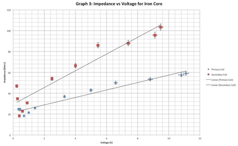

these graphs are all for the Iron core transformer.
As I thought the effency-voltage graph looked like an inverse-inverse relationship (1/x =1/y) (The last graph with no title)
But shouldn't it go through origin?

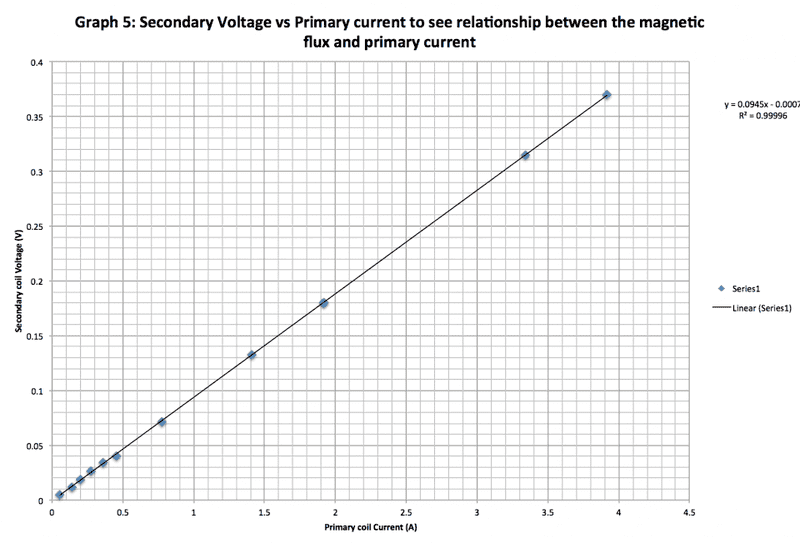

Also, I was looking at what variables i had to control.
I know that the number of coil is controlled by me along with the temperature by using therostat and also the small breaks i took after the wire got too heated.
But when i thought that i controlled the impendance by using 50Hz AC Current and the same wire for all experiment; I remember that my graph says different impendance so i thought someone may help me clarify this.
Anything else that i controlled by using my method?The method went like this:
  • Powerpack attached to rheostat
  • rheostat attached to digital ammeter
  • Digital ammeter attached to Transformer coil (primary winding)
  • Transformer coil attached back to powerpack.
  • The digital voltmeter attached in parallel to the primary coil.
  • The secondary winding was attached to another Digital ammeter.
  • The digital ammeter attached to a bulb of 2 ohms.
  • Bulb attached back to the secondary winding.
  • Another digital voltmeter attached in parallel to secondary winding.
  • All wires were copper wires.
  • All the voltage and current readings were taken from the respective devices and recorded.
Same equipments was used for alll trials and experiment.
i'm really confused.
Graph 1 says it's efficiency vs voltage but it doesn't look much like the last graph(untitled)
did you swap axes or something ?
How can you get to origin plotting Pout/Pin ? Origin for that ratio has zero in denominator, and you know one has to be wary of any ratio with a denominator that's infinitesimal. One arranges his experiments to avoid them.
old jim
By the way -
nice job with this one.
Gives one confidence when a result comes out just what physics says it should, doesn't it ?
