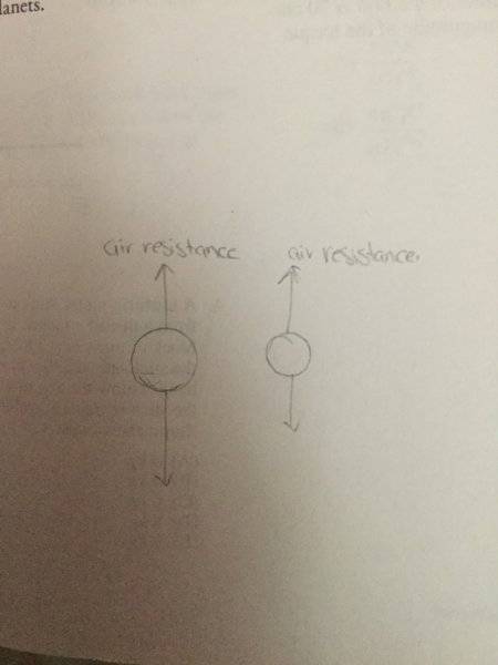

I am not sure about my free body diagram, but here it is anyway...
The net force is downward for the large ball to have it accelerate more thant the smaller one. So again it has less mass. Still I am confused between E and D. Can’t understand them either.
I can only think of E as it says that the smaller ball has larger mass regardless of the reason that I don’t understand. But it should have larger mass for it to accelerate less. I am nit sure where its net force will point, it is either constant or that it point upward meaning that air resistance is dragging it upward and slowing its motion.

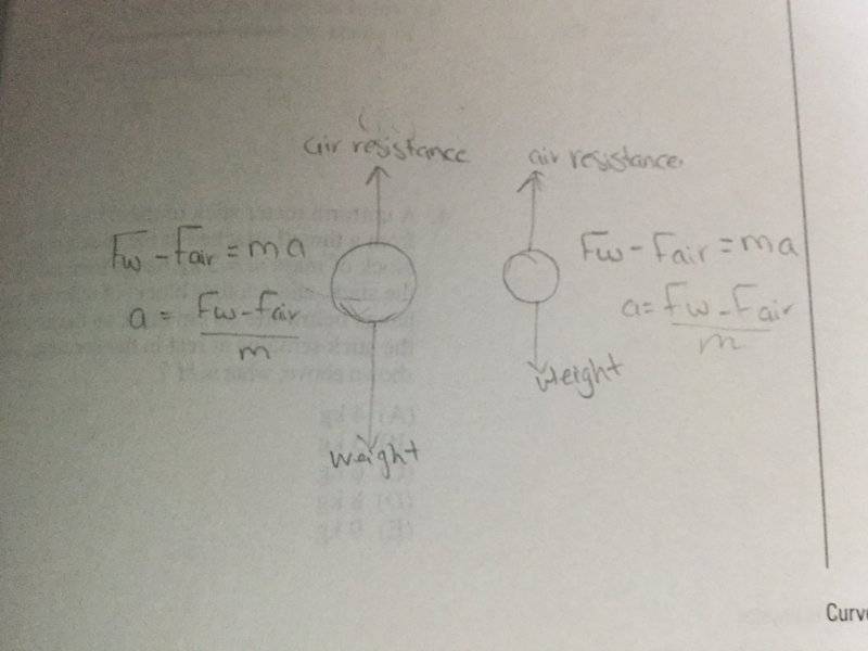

This rule has nothing to do with surface area, I mean it doesn’t contribute to the acceleration of the balls.
I doubt what I did, though.

Ok great, I see your equations, they are correct, let me expand them just a bit so the acceleration of a falling ball is
##a=\frac{F_w}{m}-\frac{F_{air}}{m}=g-\frac{F_{air}}{m}## (can see that ##\frac{F_w}{m}=\frac{mg}{m}=g##)
So the acceleration of a falling ball is ##g## MINUS a fraction ##F_{air}/m## . For which ball, this fraction becomes smaller, so the overall acceleration becomes bigger?

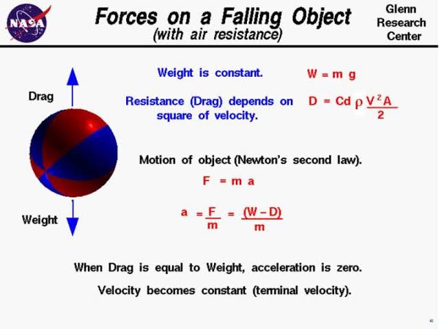

What do you know about the air resistance on a moving object, how it depends on its surface, velocity, density e.t.c?
This fraction is smaller for the larger ball.
Actually I don’t know. Is that a rule or something?
Ah, I got that. So, the larger ball has more area and thus more force of drag.

Yes more drag for the larger ball, however the fraction ##\frac{F_{air}}{m}## is smaller for the larger ball.
So, D) is also not correct because it must be smaller for the larger ball. That leaves C.
Essentially what D) tell us is that the fraction ##F_{air}/m## is smaller for the larger ball, but you got to do the math behind it to understand it. Substitute ##F_{air}## =(##D## drag in the latest picture you gave us) with the formula you have from the latest picture you gave us and do some math.
