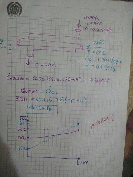

Hello. First of all sorry about this question, it has to do a little with heat transfer from engineering. This situation is not real, I was working in a proyect and this doubt came to me.
I have a heat exchanger of parallel tubes. Water flows in a tube and oil flows in another one. The initial conditions are shown in the picture. I will write them here:
Water
To= 18°C
Tf= 26°C
m=0.25 kg/s
cp= 4.18 kJ/kg°C
Oil
To: 0°C
m= 0.1 kg/s
Cp= 1.79 kJ/kg°C
Q= m.cp (Tf-to)
I found the heat transfer from the water to the oil
Qw= (0.25)(4.18)(26-18)=8.36
This is the same heat that comes into the oil.
So
8.36=(0.1)(1.79)(Tf-0)
Tf= 46.7°C
This result does not make sense to me, because I find impossible that the oil has increased its temperature more than water. I thought that the maximum possible temperature than the oil can reach is the same 26°C of water ( Assuming an infinite length in the heat exchanger)
In the picture I put a axis with the temperatures.
Could anyone explain me why, according with the calculations, I got Tf= 46.7°C for the oil?

I assume you meant the other way around. Heat is being transferred from the water to the oil, right?
Quite so. It won't happen. The best arrangement in a heat exchanger is that the flows are opposite, i.e. the incoming cool fluid is adjacent to the exiting warm fluid, etc. In this way, the oil might get close to 26C, but never quite there.

I wrote incorrectly one part, I am sorry! The water comes in with 26°C and comes out 18°C.
Yes, I know the best arrangement is with the counterflow heat exchanger. I agree with you, the oil will get closer to 26°C, but how can I prove that with calculations? Because according with calculations, I will get the 46.7°C
It is a case of garbage in, garbage out.
Assuming you meant T0 for the water is 26C (please confirm), you have specified a result (final temperature of the water as 18C) that simply will not happen.
Instead of specifying Tf for the water as 18C try setting the water and oil to have the same final temperature.
