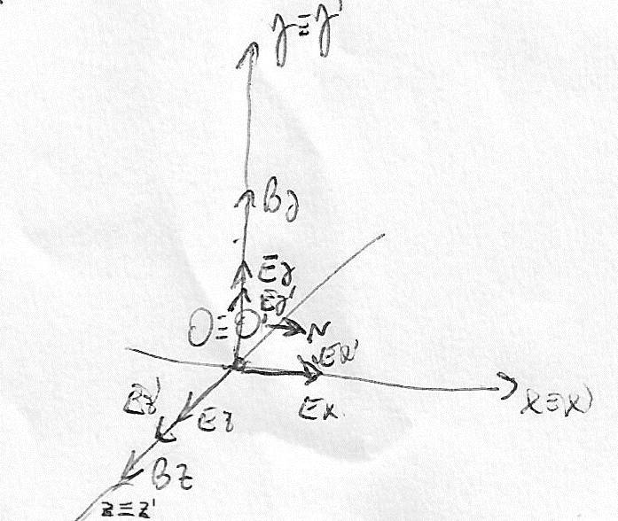

I think I could explain my problem a little better.
See this:
You have for O Ex = Ey = Ez and By = Bz and Bx = 0.
For O´moving to positive Xs axes with velocity v, E´x´ = Ex and E´y´< Ey and E´z´ > Ez.. . being Ey = Ez.
So my problem is that E´z´> E´y´... why?! I see a completely axial simetry around X axe that coincides with X´ axe.
Mmmmm... there is not completely simmetry!
Understood! :-)
