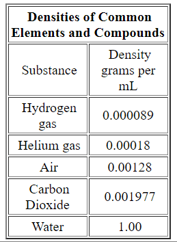

Does the helium sink toward the center as it's denser than hydrogen?
Source: http://chemistry.elmhurst.edu/vchembook/123Adensitygas.html
Your molecular density chart isn't applicable.
Helium is more dense than hydrogen but your chart compares H2 to He, molecules with electron shells.

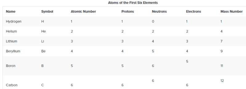

Something like this would be more applicable ( mass number ), where the number of protons and neutrons relates to the density, with nothing to do with atomic density or molecular density.
