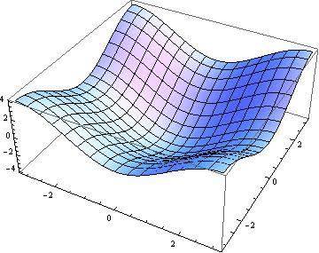

The type of curve I was talking about would be something closely related to the following diagram, which is a plot of the dispersion relation for a 2-d square lattice tight binding model ##\epsilon(k_x,k_y)##

I chose the 2-d lattice example with nearest neighbour harmonic coupling to make contact with the OP, which involved waves observed as a result of deformations of level water.. So I thought this 2-d lattice system was well suited for illustrating the propagation of waves over a surface due to local height/position differences measured normal to the surface. But yeah, I guess the 1-d version would have been a slightly simpler example, but not all that much given that the system has translational invariance in both x and y directions, so the 2-d dispersion surface (which I mistakenly called curve earlier) simply ends up being a sum of the dispersions for each of the directions which exhibit translational invariance and you can superpose modes over both directions without them affecting each other, i.e. introducing a second dimension doesn't affect the modes associated with the first. For the dispersion surface
of the tight binding model it's simply $$\epsilon(k_x,k_y) = \epsilon_0 - 2t_x\cos{k_xa} -2t_y\cos{k_ya}$$
where the hoppings ##t_x=t_y## for the surface above, ##\epsilon_0## is the on site energy and ##a## is the lattice spacing. Point being that when 2-d systems exhibit translational invariance along ##\textit{orthogonal}## directions of space, you can just sum the dispersions of each. The orthogonal there though is important though! As has been mentioned already (probably getting sick of hearing it:p), dispersion arises from the form of the interactions as well as the lattice geometry. In fact, if instead of a square lattice, we considered a sawtooth lattice, you could still retrieve translational invariance by realising that the system is equivalent to allowing next neighbour hoping, alongside the standard nearest neighbour hoping. Then, it becomes possible to choose your couplings (interaction strengths) such that you obtain a system whose lowest energy band is flat, i.e. a completely dispersion-less system, under a critical filling. The following PR B paper published last year is an example of such a dispersion-less "medium": http://arxiv.org/abs/1407.6018.
