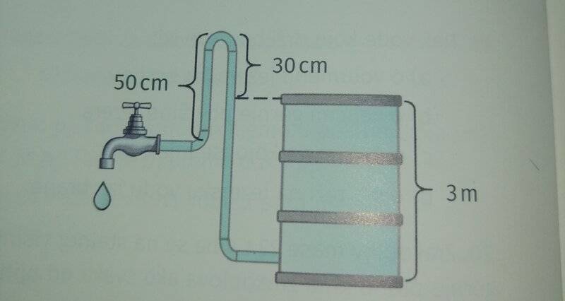

Can you please explain to me why is this the case? Thank you.
Hidrostatic pressure = gravitational constant * density * height
Picture below
can someone please explain me why will the water come out of faucet with the pressure of 2000 Pa?
I was expecting the answer to be "water will not come out thrugh the faucet because the pressure from the barrel is not strong enough to overcome the height of the pipe" since pressure depends only on height, gravitational constant and density of liquid, which is in this case water.

As long as the pipe is full, the faucet is below the height of the water it will drain until the tank water drops by 20cm.
If the pipe is empty it’s not going to make it over the hump unless the tank is pressurized above atmospheric pressure.

oohhh yeah, I didn't realise that pipe was full.
thank you.

In the absence of atmospheric pressure, the water will come out of the faucet with initial pressure of 5000 Pa*. The water in the tank side of the pipe will stay where it is if the tank is sealed, or run back into the tank (which may overflow) until the pipe level matches the tank level.
This will happen so long as the atmospheric pressure is less than 3000 Pa, even if the pipe is initially filled (presumably by filling with pressurised water through the faucet.) Once atmospheric P exceeds 3 kPa, then siphonic action works.
*This is of course 0 Pa atmospheric pressure plus 5 kPa hydraulic.
If that sounds paradoxically larger than 2 kPa, the 2 kPa you give is relative to atmospheric pressure, so the absolute pressure at the faucet is 102 kPa - as it needs to be to push its way out against the surrounding 100 kPa air.
I guess I really didn't think into it too much, but in the initial state shown the tank must be sealed, and under greater than atmospheric pressure at the upper surface. Given a sealed tank I don't think the siphon action could work. I don't believe much of anything would come out of that faucet for any extended period of time. How much that would come out would be dependent on how much the barrel expanded from its original volume given a static head of 30 cm (assuming the water itself is virtually incompressible). I doubt that is any significant volume.
Quite so. Just considering the possibilities.
Once I talked about zero air pressure, the water won't stay in the top of the tube, unless the faucet is shut and tank sealed. So after you've somehow forced the water in and closed all exits, you start the expt by opening one or both ends.

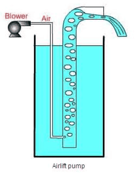

Or perhaps not, if they lower the density of the liquid? One way of pumping water over a barrier is to blow air bubbles into the ascending pipe, so that the water level in that pipe is higher than in the source, and simply let it overflow the barrier. There may be a kinetic element at work here, but this tries to improve on the static mechanism.
IMO it still comes down to the more dense liquid pushing the less dense mixture, rather than anything sucking.

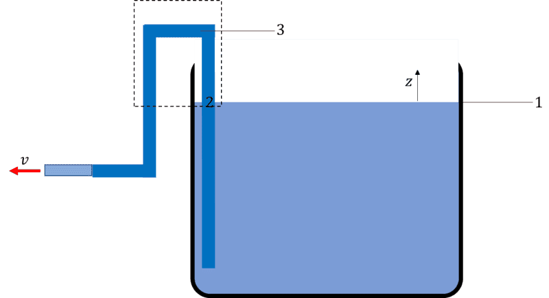

IMO:
The entire contents of the dashed box are under vacuum if flow is established with some velocity ##v##.
Start by applying the "Energy Equation" between positions 1 and 2 (under the assumption of steady flow - not time varying). 1 is the free water surface, and 2 is located inside the pipe at the free water surface. The tank is assumed to larger that the pipe. It doesn't have to be, but it makes the result more obvious.
$$ \frac{P_1}{\gamma} + z_1 + \frac{v_1^2}{2g} = \frac{P_2}{\gamma} + z_2 + \frac{v_2^2}{2g} + \sum_{1 \to 2} k \frac{v_i^2}{2g} $$
##P_1## is 0 gage
##1## is the elevation datum ##z_1 = z_2 = 0 \rm{elev.}##
The tank is assumed large as such ##v_1 \approx 0##
The last term is a generic head loss term for any real (viscous flow) it is always positive for any established flow in the system.
By continuity (constant pipe diameter) ##v_2 = v_i = v##
We find that the pressure inside the pipe at ##2## is given by:
$$ \boxed{ \frac{P_2}{\gamma} = - \left( \frac{v^2}{2g} + \sum_{1 \to 2} k \frac{v^2}{2g} \right) }$$
Thus, the pressure at ##2## is necessarily at vacuum (and is it atmospheric just below it).
We can do the same analysis for ##2 \to 3##:
$$ \boxed{ \frac{P_3}{\gamma} = \frac{P_2}{\gamma} - \left( z_3 + \sum_{2 \to 3} k \frac{v^2}{2g} \right) } $$
It should be apparent that ##P_3## is the peak vacuum pressure in the system. Also, ##3## has a limit, as the pipe rises higher and higher, the pressure ##P_3## is approaching the vaporization pressure of the liquid. Cavitation will occur at some maximum elevation for the siphon at ##z_3## and the flow will be interrupted as the bubbles expand.

Merlin3189 said:
The air pressures may be the same, but presumably the liquid pressures differ, else why would the water come out?
The pressure at the surface ##1## and the fluid jet are the same almost immediately after the jet exits the pipe. The pressure change propagates at the speed of sound in the fluid.
