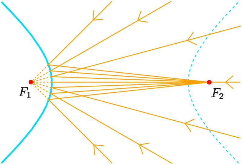

sophiecentaur said:
I don't think so. A convex hyperboloid diverges rays and has a virtual focal point (behind the surface) - same as any convex surface. The context is a cassegrain telescope which uses a convex reflector which, in conjunction with the paraboloid main reflector produces a real image but that is not what the bare statement about two foci implies.
As far as I know, the statement is true. Any ray directed at one focus will be reflected towards the other, regardless of how that ray gets directed towards the first focus in the first place.
But it's a diverging mirror if it's convex. No?
What goes for a convex lens, goes for a concave mirror.
Yes, but in order for the rays to be directed towards the focus, they have to be converging. I guess you could say the convergence of the rays is greater than the divergence introduced by the mirror, thus the rays end up being focused at the other focus.
@sophiecentaur See the following diagram.
Edit: Imagine the blue surface is bendable. If we start with a sphere and direct the rays towards the focus, it is obvious that they simply reflect back along their original paths. As we bend the surface outwards, away from F1 , we make it ellipsoidal, and the reflected cone of rays begin to diverge less and less. Once we bend the surface into a parabola, the reflected rays are now parallel to each other, or collimated. Finally, once we bend it further into a hyperbola, the light rays begin to converge after reflection and are focused down to a point.
As others have said, you are misunderstanding. Here is the explanation from Wikipedia, and below is a digram.
"It makes use of the special properties of parabolic and hyperbolic reflectors. A concave parabolic reflector will reflect all incoming light rays parallel to its axis of symmetry to a single point, the focus. A convex hyperbolic reflector has two foci and will reflect all light rays directed at one of its two foci towards its other focus. The mirrors in this type of telescope are designed and positioned so that they share one focus and so that the second focus of the hyperbolic mirror will be at the same point at which the image is to be observed, usually just outside the eyepiece. The parabolic mirror reflects parallel light rays entering the telescope to its focus, which is also the focus of the hyperbolic mirror. The hyperbolic mirror then reflects those light rays to its other focus, where the image is observed."
@sophiecentaur , perhaps what you are misunderstanding is the following. You are right that with parallel incoming rays, a convex surface will convert these to diverging rays. But in a Cassegrain telescope, the incoming rays to the hyperbolic secondary are already converging, so the hyperbolic secondary converts them to converging rays at a different focus.
