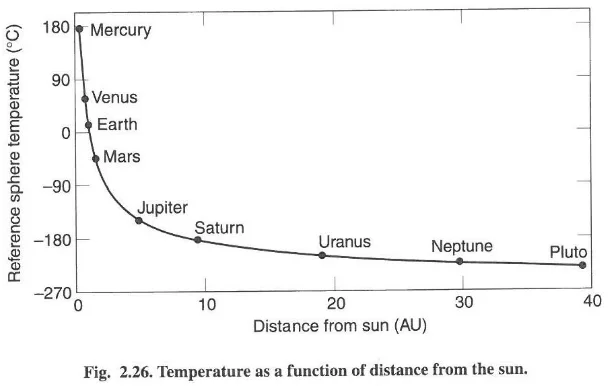

The GHGs are in a long vertical column ('cylinder' of air) of the atmosphere. This is a diurnal effect so it's not simple; you can't really have an equilibrium state. BUT the GHGS near the ground will be in temporary equilibrium with the ground. They do not absorb the higher frequencies wavelengths so that (most of) solar energy gets to the ground and the GHGs will also absorb some incident energy. The ground radiates IR (solids will end up at a black body temperature of about 300K). This IR is absorbed by the nearby GHGs which then warm up and radiate IR upwards and downwards. A (brief) equilibrium will occur. The upward radiation is absorbed by the higher GHG layers etc. etc. and the column is then in equilibrium with a temperature gradient. The ground heats up a lot more than if there were no GHGs in order to radiate incoming and outgoing energy. The presence of clouds is also a similar effect. On clear nights the ground cools very much faster than with clouds.
With no GHGs, most of the ground's radiant IR will exit to space (even more than on a clear cloudless night) so the average ground temperature would end up at about 10C with huge diurnal / annual variations.
From https://space.stackexchange.com/que...temperature-of-a-satellite-orbiting-the-earth

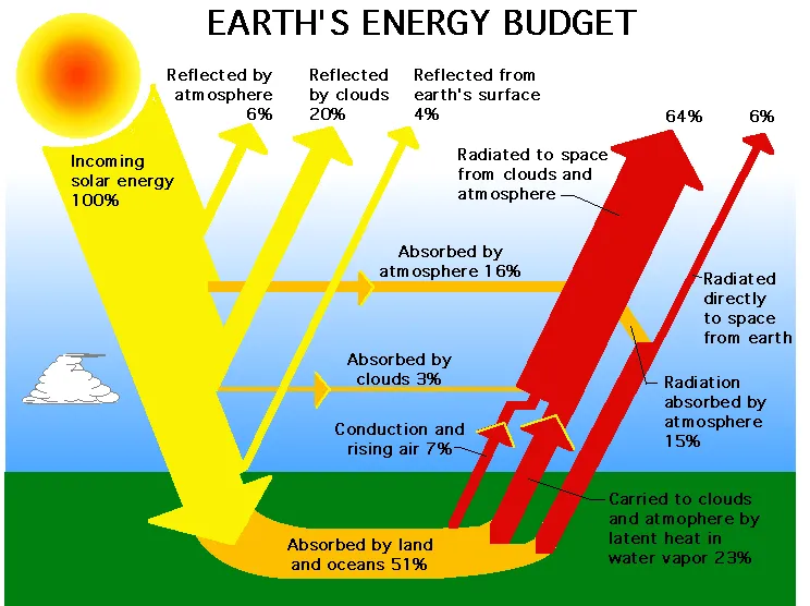

The surface radiates and not all of that energy is absorbed by the atmosphere:
https://scied.ucar.edu/learning-zone/how-climate-works/energy-budget
Without greenhouse gasses, the 6% that is directly radiated to space from the surface goes up and the 15% radiated by the surface that is absorbed by the atmosphere goes down.
