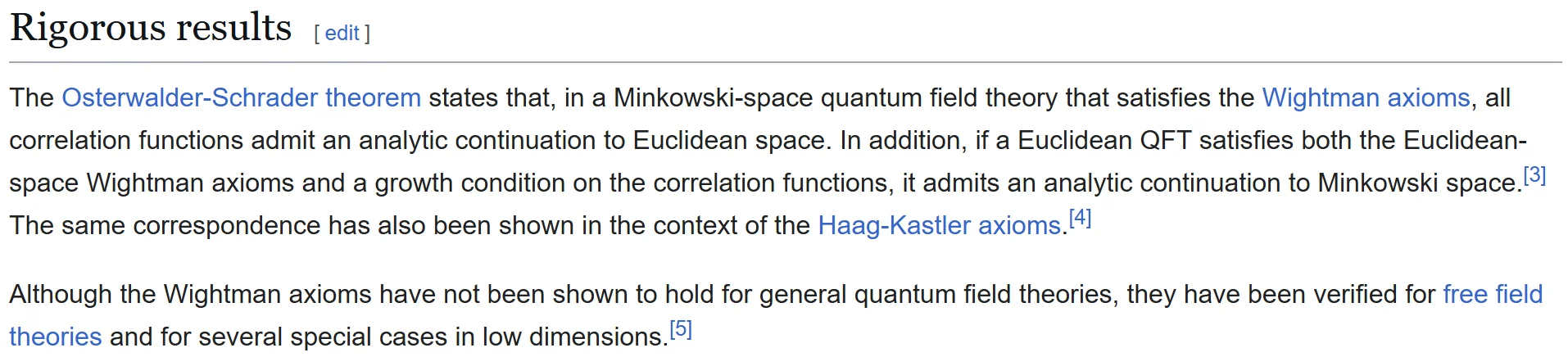

wnvl2 said:
Is Wick rotation merely a computational trick, or does it rely on additional assumptions about analyticity, convergence and the singularities of the integrand? How can we be sure that analytic continuation back to real time recovers the original physical result?
Have you looked here: https://en.wikipedia.org/wiki/Wick_rotation and the references therein? In particular, that link states:
No. Thankyou for the reference. In the meantime I have als a simple answer from AI:
