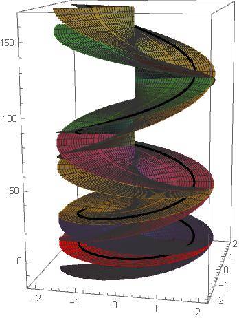

I am trying to understand the branching geometry of the Dilogarithm function as described in Branching geometry of Dilogarithm. In Theorem 8.6, the following (dilogarithm) definition is given by letting ##n=2##:
\text{Li}_2(z)=\text{Li}_2^{(k_0,k_1)}(z)=\text{Li}_2^{(0)}(z)+\sum_{m=0}^1 k_m\binom{1}{m}(2\pi i)^{m+1}(\text{Log}(z))^{2-m-1}
but it's not clear at all what ##k_m## is and was wondering if someone would know this?
For example, suppose I wanted to plot an analytically-continuous ##6\pi## route via ##z(t)=2e^{it}## over it's Riemann surface, how would I splice-together the pieces defined above over the branch-cuts ##(-\infty,0)## and ##(1,\infty)## beginning on the principal branch ##\text{Li}_2(2)## so that the path traverses an analytically-continuous over them?

stitch the MapleSoft sheets together by trial-and-error over this path to create the (real) plot below showing the analytically-continuous route through the function along this path in black. However that's not practical and was hoping to better understand the formula for ##\text{Li}_2(z)## above to do this systematically by supplying the correct indices ##k_m## I assume.

The reason I'm asking is because my experimental results via the IVP above do not agree with the MapleSoft definition of incrementing by 2πi (or Lewen's apparently) each time the branch cut (−∞,0) is crossed. In the plot I showed above, I needed to increment some of the branching by just πi to obtain an analytically-continuous route through the function so I wanted to know what is causing this discrepancy.

In my initial post above I described differential-continuation of the Dilogarithm function. However, it was poorly described and I wish to better do so here so that that interested reader can understand the principle when the DE of a multi-valued function contains itself, a multi-valued function: First continue the contained multi-valued function, then use that version in the original DE. Below, first continue ##\log(1-z)##, then use it in the Dilogarithm IVP to subsequently continue Dilogarithm:
Letting ##z(t)=1.5 e^{i t}## with ##0\leq t\leq 6\pi ##, ##u(z)=\log(1-z)## and ##f(z)=\text{Li}_2(z)##, first continue ##u(z(t))## then use ##u(t)## in the IVP for the Dilogarithm. That is, in this particular example, starting on the principal-valued log sheet, numerically solve sequentially,
\begin{align*}
\frac{du}{dt}&=-\frac{1}{1-z(t)}\frac{dz}{dt};\quad u(0)=\text{Log}(1-z(0)) \\
\frac{df}{dt}&=-\frac{1}{z(t)}u(t)\frac{dz}{dt};\quad f(0)=\text{Li}_2(1.5)
\end{align*}
This is how the (Re) black contour along the sheets of Dilogarithm in the plot above was generated.
