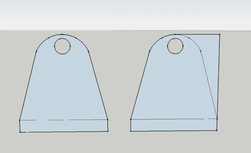

I'm trying to decide whether to add material to my piece in this location and if it will make it stronger.
The piece is attached to a plate and will experience a horizontal rotational force. Will adding that extra piece in the design make it stronger?
I would be more concerned about strengthening the thin section between the hole and the top radius on the component .
I'll have to look into that as well, but there shouldn't be much force in that direction.
