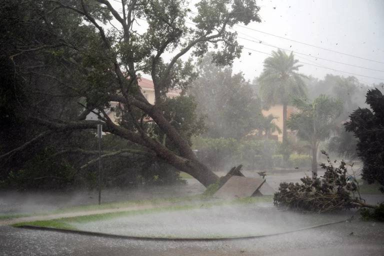

Baluncore said:
... Trees are blown over during windstorms, especially during unusually bad droughts, when the sucker fails to seal in the dry cracked soil.
Even when air can't flow underneath the roots, Florida sandy soil is known for liquefying in floods and removing much of any tree's resistance to tipping moment for any tree.
https://www.accuweather.com/en/weather-news/why-trees-topple-in-high-winds/348991
Specially during hurricanes, there is previous period of intense rain before the eye of the hurricane arrives.
The soil then becomes saturated quickly and following hurricane-force winds can do much damage to big trees of foliage and tall palm trees.
