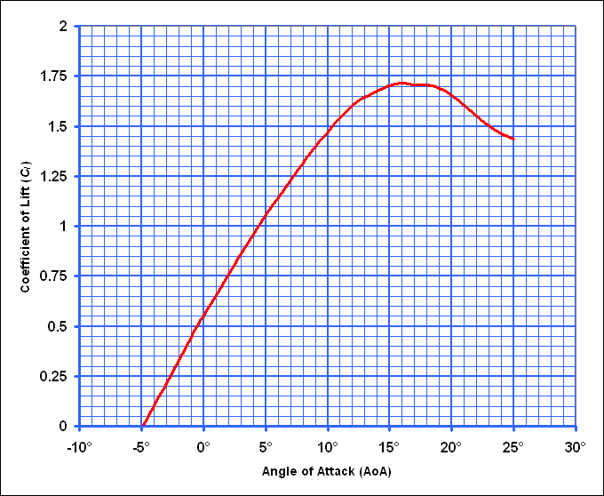

The discussion centers on the aerodynamic principles explaining why the bottom of a wing is typically flatter than the top. It is established that lift is generated by creating a lower pressure area on the top surface due to a longer, curved airflow path, resulting in higher air velocity compared to the flatter bottom. This configuration is crucial for optimizing lift-to-drag ratios, particularly in various aircraft designs, such as the NACA 4415 airfoil, which demonstrates lift even at zero angle of attack. The conversation also highlights misconceptions about lift generation, emphasizing the importance of angle of attack and circulation theory in understanding aerodynamic performance.
