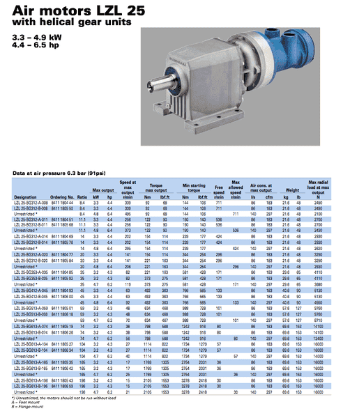

Hi Everybody
The plan is to build a trompe in rural Nepal.
Has anybody here built one?
Sure would love to hear from you.
I believe we could generate enough psi to run a pneumatic motor that puts out 8.4 hp possibly more but i would like to start there and see what sort of output we could expect from an 8.4 hp motor.
I'm struggling with some electrical questions, one being what alternator could produce the most energy from that 8.4 hp
I have searched but can't find what I'm looking for, mostly because i don't really know what I'm looking for and specs on ones i found, when present, don't make much sense to me.
We obviously want the maximum AC output possible.
Another question is what happens after the alternator?
What do i need to stabilize and distribute what was being produced?
Any other aspects of the electricity side of this you could chime in on with suggestions that would be great.

Start with the primary engineering consideration:
You first need to find whether there is enough flow and height to supply 8kW of continuous power output (with lists to spare to cope with an efficiency of, 80% (a reasonable figure for a small hydroelectric system). That means you need about 10kW of raw power from the flowing water. There are many combinations of height and flow rate but examples would be:
100m height and 1l of water per second (I think that flow rate would involve much lower efficiency)
10m and 10l per second
Power in Watts = hmg Height in metres X flow rate in kg per second X g
You need to check that you have that sort of supply capacity. It's not a vast amount and hydro power is surprisingly good value - if you have the free water in the first place.
How is it looking so far?

On the pneumatic motors i attached a screen shot of a chart that has specs for a variety of motors.
They also have larger ones but it seems like a 4.4 hp one would be a good one to shoot for.
My friend will probably build the permanent magnet alternator from scratch but if i can find something off the shelf it would be nice to know we have another option.
