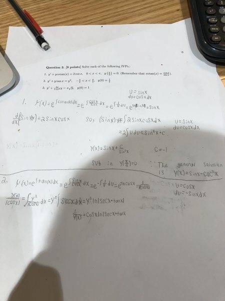

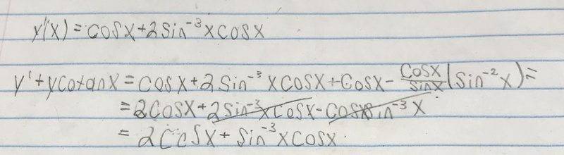

I am having trouble proving if the equation i have found for number 1 is correct. I have posted my solution to get back to the main problem in the first photo below.
For number 2 I am having trouble isolating for 1 y(x). Did i do the integration and setup properly?
Question 1:
given y' + ycotanx+2cosx (1) and y(π/2)=0 find the IVP.
find the integrating factor from equation 1.
μ(x)=e∫cotanxdx=sinx (2)
multiply equation 2 by 1.
y'sinx+ysinxcotanx=2cosxsinx
(sinxy)'=2cosxsinx (3)
integrate equation 3.
sinxy=∫2cosxsinx=sin2x+c (4)
Isolate y in 4.
y=sinx+c(csc2x)
plug in the initial value to find c which is found to be -1.
y=sinx-csc2x (5)
proving that this is a solution to the differential:
take the derivative of equation 5.
y'=cosx+2csc2xcotanx
plug y and y' into differential equation 1.
y'+ycotanx=cosx+2csc2xcotanx+cosx-cotanxcsc2x
2cosx+3csc2xcotanx
I cannot get an answer for 2cosx. I did everything right.
For Question 2:
y'+ytanx=y2 (1) for y(0)=1/2
find an integration factor.
μ(x)=e∫tanxdx=1/cosx {2}
multiply equation 1 by 2.
(y(x)/cosx)'=y2/cosx (3)
integrating equation 3.
y(x)/cosx=y2∫secx=y2ln|secx+tanx|+c (4)
isolating y in equation 4.
y(x)=cosxy2ln|secx+tanx|+c(cosx) (4)
Here is where I get stuck i don't know how to isolate for y.

As you can see y'+ycotx should equal 2cosx but when proven it equals 2cosx+sin-3xcosx

Question 1:
Isolate y in 4.
y=sinx+c(csc2x)
This is incorrect. From ##y \sin x = c + \sin^2 x## we get ##y = c/\sin(x) + \sin(x) = \sin(x) + c \csc(x)## (not ##\csc^2(x)##).

For Question 2:
This is incorrect. From ##(y/\cos x)' = y^2 / \cos x## you get ##y / \cos x = \int y(x)^2 / \cos x \; dx##. You cannot pull the ##y^2## outside the integral sign.
Integrating factors do not work for nonlinear differential equations, and yours is definitely nonlinear because it contains ##y^2##.
