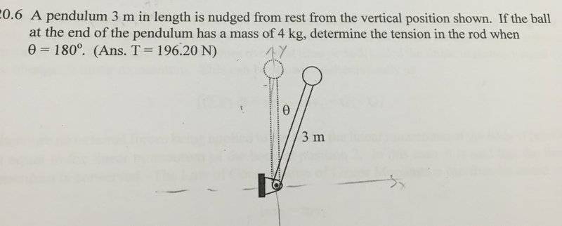

Refer to figure.
U=Fs
T=.5mv^2
Vg=mgh
I am not exactly sure where to start. I would appreciate if someone could nudge me in the right direction and then go from there.
Start with a free body diagram of the mass when theta is 180. Write out the ΣF=ma equation for it.

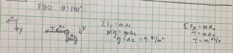

I have done that but I am not sure how to get the velocity of the mass...
Your diagram seems to be for theta = 90 degrees.
For the velocity, any conservation law come to mind?
(In your 'relevant equations', I don't understand Vg=mgh. What is Vg there?)

yeah my figure is incorrect. Vg is the gravitational potential energy
