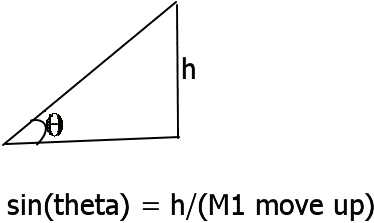

System is initially at rest, if m2 falls a distance h. What is the work done by gravity on the system.
Given: Theta, m1, m2, h
The image looks fairly similar to this.
I'm going to go ahead and assume we are using Work(gravity)=The change in gravitational potential energy(ΔU) for this problem
So I posted this question somewhere else, and got the reply "Here loss in Gravitational potential Energy of M2 = M2gh
Gain in Gravitational Poetntial Energy of M1 = M1gh/sinθ
Therefore
= M2gh - M1gh/sinθ
= gh(M2 - M1/sinθ)"
M2 made sense to me, but the equation for m1, did not, so I questioned him on his method of arriving at that and he gave me the image he made...
Ok, so I see what he did. Sin(θ)=h/x, fine, but in doing that, he is assuming the total height is h, and the problem states "m2 falls a distance h," not "height of the triangle is h," or "Both m1 and m2 start from h" Also, when plugging this into his m1 equation 'm1gh' for h, he used x, not h, and h would equal h=xsin(θ), but we don't know x. I think he justified it by stating x='m1 move up' which is not the case, as x is the hypotenuse, which would be the distance the block moves up the ramp, not the final height. If this were the case, then gravity would be also dependent on a displacement, as well as height, which would make it a non-conservative force, right? But we know gravity is conservative.
Just confused tbh, I feel dumb for not being able to answer such a seemingly simple question :/
When M1 moves a distance h along its incline, it rises a distance A
where
A = h * sin (theta)

So what your saying is, the distance m1 moves up the slope is the same as the height m2 fell.
Ok, but we still arn't given that they both start at the same height... If we work out the math, having our potential energy reference at the bottom of the incline (h below m2).
W(g)=ΔUg
W(g)=(Ugf-Ugi)m1+(Ugf-Ugi)m2
W(g)=(m1ghsinθ-m1gy)+(0-m2gh) Where y is the initial height of m1
W(g)=g(m1hsinθ-m1y-m2h)
Except we still don't know what y is...
It doesn't matter if "they both start at the same height". All that is important is one rose and the other fell the same distance.

Perhaps I'm misreading what you just said, but here's the thing. No one has been saying that the two vertical-motion componsents are identical. Quite the contrary. If a mass moves from the top of an incline down vertially to the ground 10 feet then another mass that is connected to it via a rope, and is on a long 10 degree incline it will move along the incline for 10 feet and its vertical motion will be 1.7 feet.
