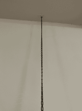

A chain of length 'L' and mass 'M' and also has an uniform linear mass density. The chain hangs from a support as one of it's end is attached to it, while the other end is free and is hanging downwards. Find the work done by gravity on the entire hanging chain.
W=F.S
I tried taking an element of length dx and tried calculating the force of gravity acting on it so that I could just integrate over the whole chain, but I couldn't figure out what to do of that displacement part since the dx element is not moving as is just at rest (hanging). So, how should I proceed with the integration? (A picture has been attached for reference of the above situation.)
If the chain is just hanging there, is any work being done?
since, there is a difference in the P.E of the 2 ends of the chain, there should be a work done cause the work done by conservative forces (which here is just gravity)= -(change in P.E)

Work is done when there is a change in potential energy over time.
A change in potential energy over displacement does not qualify as work and would not have the same units as work.
In an advanced class, you may learn that change in a potential over displacement is called the "gradient" of the potential. For a scalar potential (like gravity) the gradient is a vector. In the case of gravitational potential the gradient is the local acceleration of gravity.
It would be meaningful to ask how much work was done by a chain that was laying motionless on a horizontal frictionless surface and then slowly lowered through a frictionless hole in the ceiling to end up in the pictured configuration.

But if it is just hanging there, there IS no change in P.E. --- as jbriggs said, you need a change in P.E. OVER TIME.

Are you asking how the potential energy of a 10 cm length of chain at the top, near the ceiling can be different from the potential energy of a 10 cm length of chain at the bottom, farther from the ceiling?
Answer: They are different because the two lengths are at different average heights.
Are you asking why no work is done by gravity?
Answer: Because there is no motion. The chain is hanging motionless.
You could ask how much work would be performed by gravity if the 10 cm length of chain near the top was slowly lowered to the same height as the 10 cm length of chain at the bottom.
Answer: The work done by gravity on that 10 cm length of chain would be equal to the difference in the two potential energies.

The difference in potential energy between two states for a single body is equal to the work that would have been done by an external force to move it slowly from the initial state to the final state.
So for instance, the difference between the potential energy of a sled at the top of a hill and the same sled at the bottom of the hill is equal to the work that a child would need to do on the sled, dragging it slowly up the hill over frictionless snow.
In the case of the hanging chain, you have not identified an initial state and a final state.
