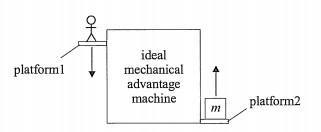

An engineer that has a mass of 100kg has made an ideal mechanical advantage machine shown in the attachment. Platforms 1 and 2 are attached to the machine. When he steps on platform 1 it goes straight down and platform 2 rises straight up. The maximum weight he can lift using this machine is twice his own. Platform 1 can be lowered to a maximum of 10m. The mechanical advantage of the machine cannot be adjusted.
Assume the mass (m2) is twice the mass of the engineer (m1) and that he gives a slight push down to get the mass moving. Including the push, the work done on the mass as platform 2 rises to its top height of 5m will be equal to:
a) the original potential energy of the engineer
b) the final kinetic energy of the engineer
c) original potential energy of the engineer plus half the final kinetic energy of the engineer
d) original potential energy of the engineer minus the final kinetic energy of the engineer
The answer is C, but I do not understand why my approach does not work and how they reach their conclusion.

4. The solution provided
The net force of both masses is zero so the velocities from the push remain constant. The work done on the mass is W = m2gh2f + 1/2m2vo22, and 2m1=m2 2v2=v1 2h2=h1. The work done on the mass in terms of height, velocity and mass of the engineer is W = m1gh1 + (1/2)[(1/2)(m1vo12)]
5. What I do not understand
How can the final kinetic energy of the engineer not be 0J? The platform is not moving once he moves the maximum distance the platform can travel.
I thought about maybe changing how I define final and initial velocities. I'm thinking maybe I could consider the final velocity to be the velocity right before it stops and the initial velocity would be the platform resting before the push is initiated. If I do that then I get the work done on m2 to be:
W = m2gh2f + 1/2m2vf22.
Once I put it in terms of m1 I get W = m1gh1o + 1/2[(1/2)m1vf12]
If this is the way of getting the answer what was wrong with my original approach to model the problem? Was I not including the push by the engineer?

Hello Pino, and welcome to PF.
Your initial apology is quite unnecessary: the platform is there to ask questions and we always claim there are no dumb or annoying questions. In fact you deserve a compliment for such clear and good use of the template and your inventive extension!
I like the exercise because it requires careful reading and some imagination as well. As a physicist I am rather quicly drawn into reading "pulley" or "cogwheel", but never mind.
What I kind of must assume in this story is that the thing is exactly in equilibrium if m2= 2 m1. It is corroborated by the answer, but you are not supposed to need that when confronted with the problem, right? The author also carefully avoids claims that the usual laws of mechanics are violated ("ideal mechanical advantage"). And we read that lowering maximum of 10 m cossreponds to raising maximum 5 m.
The exactly in equilibrium thing means that the forces left and right are balanced. The only external forces are from gravity, so if they cancel the sum of all forces is 0. According to Isaac's law F = dp/dt = ma (with constant mass), we deduce from F=0 that p is constant, hence v is constant.
So if it all initially is hanging still and a push is needed to get going, the work of that push is distributed over the kinetic energy of three times m1. (keep in mind!*)
The exercise doesn't say very much about how the stopping goes, so I propose we answer the question for the "arrival phase", i.e. just before it comes to a stop. Because stopping means doing negative work (to bring the kinetic energy back to zero **). So: until arrival: all the time no F so constant v left and right.
All your work is correct, only the vi and vf assumptions are conflicting with the casus as formulated. If, as you write v1/2 = v2 (which is true at all times!) you cannot have zeroes for the final v of man and load without something that causes that and influences the energy balance (**).
In your point 5 you are thinking in the right direction: final velocities right before it stops ad initial velocities zero. (After all, the push is included in the story -- which carefully avoids mentioning anything initial under a), b), c) or d) ! ). And you come with a way to arrive at the right answer (it definitely is correct!***).
(*) So the work done with the push is two times Δm1v1 ! And the kinetic energies have -- as you show -- a ratio 2:1
(**) This way taking away the speed of the moving load at arrival means doing negative work of 1/2 m1v12 which then leaves W = m2gh2f
Lengthy answer; I think you understand the physics quite well and that's why I try to carefully nudge you to a different interpretation of the exercise formulation. Again: my compliment that you think through and please never ever hesitate to ask if you don't understand (or don't accept) what is out before you !

Hello BvU and thank you for your reply/kind words! How is the work with the push 2m1Δv1?
This is how I figured out the work done by the push from the engineer would be:
W = ΔKE + ΔPE
W = [(1/2)m1v1f2 - (1/2)m1v1o2] + (m1gh1f - m1gh1o)
Setting the initial velocity as the velocity of platform 1 before the push is given and the final velocity as the velocity of platform 1 right before it stops simplifies the above equation to:
W = 1/2m1v1f - m1gh1o
(v1o = 0 and m1gh1f=0)
Also isn't the ΔKE for any object (1/2)mΔv2
So how did you get the kinetic energy to be 2m1Δv1?

Here is how I do it:
So the work done on the objects are:
W = ΔKE1 + ΔKE2 (KE1 is the kinetic energy of m1 and KE2 is the kinetic energy of m2)
ΔKE1 = (1/2)m1Δv12 = (1/2)m1vf12 (vo12 = 0)
ΔKE2 = (1/2)m1Δv22 = (1/2)m2vf22(vo22= 0)
W = (1/2)m1vf1 + (1/2)m2vf22
and again seeing as m2=2m1, and vf1=2vf2
W = (1/2)m1vf12 + (1/2)2m1(1/2vf1)2
W = (1/2)m1vf12 + (1/4)m1vf12
W = (3/4)m1vf12
Where is my mistake?
I don't think it is you who is mistaken ! What you calculate is that (after the pushing) the kinetic energy of the mass is half that of the engineer, which is in agreement with C) being the correct answer.
The one who is mistaken is me, in post #8, when I type "Work of push = Δmv = m1Δv1 + m2Δv2". This is plain wrong ! I should have typed Force of push times Δt = Δmv = m1Δv1 + m2Δv2.
Can't say I can convince even myself completely, but with Δv/Δt = a this becomes Force = m1a1 + m2a2.
But I am unhappy to write work = m1a1 s1 + m2a2 s2 to match with the 3/4 (because s2 = s1/2). I could just as well have written that the F = 2 m1a1 has to be exercised over the full s1.
So, for a change, I am stuck and need someone else to point out the flaw in this!

Yes, there is (a flaw). The work that the engineer does in pushing is converted into kinetic energy.
Two thirds go into his own (+platform) kinetic energy:
1/2 m1v12
and one third goes into the kinetic energy of the load (+platform):
1/2 m2v22 = 1/2 * 2 m1 * (v1/2)2 = 1/4 m1v12 .​
That 's the way it stays until arrival. At arrival the platform has total energy = original potential energy of the engineer plus half the final kinetic energy of the engineer, conform answer c.
Now my own stupidities, that may have contributed to the confusion: in post 12 I correct my own post 9. Post 9 is wrong, but post 12 isn't correct either!
Force of push times Δt = Δmv = m1Δv1 + m2Δv2 is wrong. Force doesn't act directly on platform 2 & mass 2.
This is F = ma in an incorrect interpretation. Thing to do is separate into FBDs for m1 and m2 and consider the force the platform executes on the engineer during pushing too (up = positive, g = 9.81 m/s2):
on m1
-F + F2→1 - m1 g = m1 a1 ##\ \ ## so ##\ \ ## F2→1 = F + m1 g + m1 a1
on m2
F1→2 - m2 g = m2 a2
With a2 = - 1/2 a1 m2 = 2 m1 and
F2→1 = 1/2 F1→2##\ \ ## so ##\ \ ## 2 F2→1 = F1→2
this becomes
2F + 2m1 g + 2m1 a1 - m2 g = m2 a2 ##\ \ ## or ##\ \ ## 2F + 2m1 g + 2m1 a1 - 2m1 g = 2m1 (-a1/2)​
so that
F + m1 a1 = m1 (-a1/2) ##\ \ ## ⇔ ##\ \ ## F = - 3/2 m1 a1
Must admit that at first I was a little surprised at the 3/2. (previously I thought 2, so 4/2). But the 1 is used to accelerate m1 with an acceleration a1 and 1/2 is "multiplied by 2 by the machine" to accelerate 2m1 with an acceleration a1/2.
Someone can shoot a hole in this ? Receives a hearty thank you from me, but I don't think there are any takers...By the way: pino thanks/compliments to your teacher for bringing in such a simple yet challenging exercise!

I wanted to point out that F = - 3/2 m1 a1 is in agreement with W = 3/2(KE)
The proof:
W = ΔKE1 + ΔKE2
ΔKE1 = (1/2m1v1f2 - 1/2m1vo12) = 1/2m1v1f2
ΔKE2 = (1/2m2v2f2 - 1/2m2vo22) = 1/2m2v2f2
W = 1/2m1v1f2 + 1/2m2v2f2
m2 = 2m1 and v1 = (1/2)v2
W = 1/2m1v1f2 + 1/2(1/2m1v1f2)
W = KE1 + 1/2 KE1 → W = 3/2 KE1 or W = (3/2) (1/2m1v1f2)
Vf/2 = a*h (h is the distance, this is from the kinematics equation vf2 = v02 + 2ax)
W = 3/2 m*a*h → W = 3/2F*h, and the negative is not included because the force is in the same direction as the movement of platform 1.
And also pointing out another flaw in my original thinking of how the energy is transferred. If truly half of the energy that was stored in his body went into moving the mass, then the work done on m2 would have been the potential energy of the engineer plus this kinetic energy rather than half his kinetic energy.
