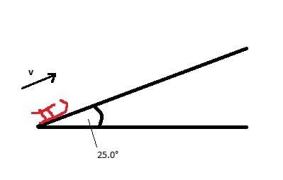

[Sears and Zemansky's University Physics, 13E] 6.19/(e)
Use the work–energy theorem to solve the problem. Neglect air resistance.
At the base of a frictionless icy hill that rises at 25.0° above the horizontal, a toboggan has a speed of 12.0 m/s toward the hill. How high vertically above the base will it go before stopping?
Work-Energy theorem
Kinetic Energy
Trigonometry
My solution is different from the official solution and I don't understand what I did wrong.
Here is my solution:
The magnitude of the initial velocity is ##|v_0| = 12.0~\rm{m/s}##, so the vertical component of the initial velocity is ##v_{0-y} = (12.0 \sin{25^{\circ}})~\rm{m/s}##.
Then I use the work-energy theorem and the work equation applicable in case of constant force and straight-line displacement.
##W = \vec{F} \cdot \vec{s}##
and
##W_{tot} = \Delta K = K_1 - K_0 = 0 - K_0 = -\frac{1}{2}v^2m##
Substituting the appropriate vertical variables, I obtain:
-mgy=-\frac{1}{2}v_{0-y}^2m \\
And then rearranging to make ##y## the subject of the equation I obtain
y=\frac{v_{0-y}^2}{2g}=\frac{((12.0 \sin{25^{\circ}})~\rm{m/s})^2}{2(9.80~\rm{m/s^2})} = 1.31~\rm{m}
However, the official solution says ##7.35~\rm{m}## which is the value I'd get if I just used the initial velocity magnitude, not its vertical component.
What am I missing?
[Edit: typo in homework statement]

1) I've made a typo in the statement, so I've edited it for clarity.
2) Right, so I've missed the normal force, haven't I? Let's see how that changes things.

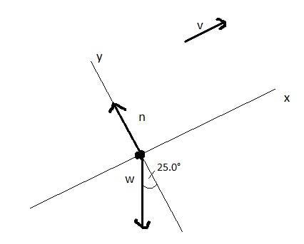

For direct applications of the W-E theorem such as here, it is best to draw a free body diagram with all the forces in place, calculate the work done by each separately, then add them all up to get ##W_{tot}.##
Likes MatinSAR and Argonaut

Thanks, @Chestermiller. I don't yet know what 'potential energy means', but the ##K_i = \frac{1}{2}v^2m## and ##K_f = 0##. So
$$W_{tot} = \Delta K = K_f - K_i = 0 - \frac{1}{2}v_0^2m$$
And then following @kuruman 's advice,
So the normal force is perpendicular to the displacement, so it doesn't do any work. The work done by gravity is ##W_{grav} = -w\sin{25^\circ}d = -mg\sin{25^\circ}d##.
Is that correct?
So then I have
W_{tot} = W_{grav} $$
$$- \frac{1}{2}v_0^2m = -mg\sin{(25^\circ)}d $$
$$d = \frac{v_0^2}{2g\sin{(25^\circ)}} = \frac{(12.0~\rm{m/s})^2}{2(9.80~\rm{m/s^2})\sin{(25^\circ)}}=17.4~\rm{m}$$
Does this look okay?
And then getting the vertical component of the displacement ##d\sin{(25°)}=7.35~\rm{m}##.
So the ##\sin{(25°)}## term just cancels out. Could I have derived ##y=\frac{(12.0~\rm{m/s})^2}{2(9.80~\rm{m/s^2})}## more easily somehow? Was trigonometry unnecessary to begin with?

Well spotted. There is an alternative trig'-free approach - it requires the use gravitational potential energy as indicated by @Chestermiller in Post #5.
However, the question as stated requires you to use the work-energy theorem so your method is correct.

The way to do this by direct application of the W-E theorem, ##\Delta K = W_{tot}##. This strategy is quite simple.
1. Find the total work done by all the forces. That's the right-hand side of the equation.
2. Find the change in kinetic energy. That's the left-hand side of the equation.
3. Set the two equal and find what the question is asking for.
Here is the implementation
1. ##W_{tot}=-mgy##. You found that already. Note that ##y## is the vertical displacement that you are looking for.
2. ##\Delta K=0-\frac{1}{2}mv_0^2##. Here ##v_0=12.5~##m/s
3. ##-mgy=-\frac{1}{2}mv_0^2.##
Note that the incline angle is totally irrelevant here. It would come into play if the problem asked to find how far up the incline the mass will travel before it stops.
Likes MatinSAR, Argonaut and Steve4Physics
