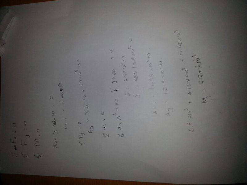

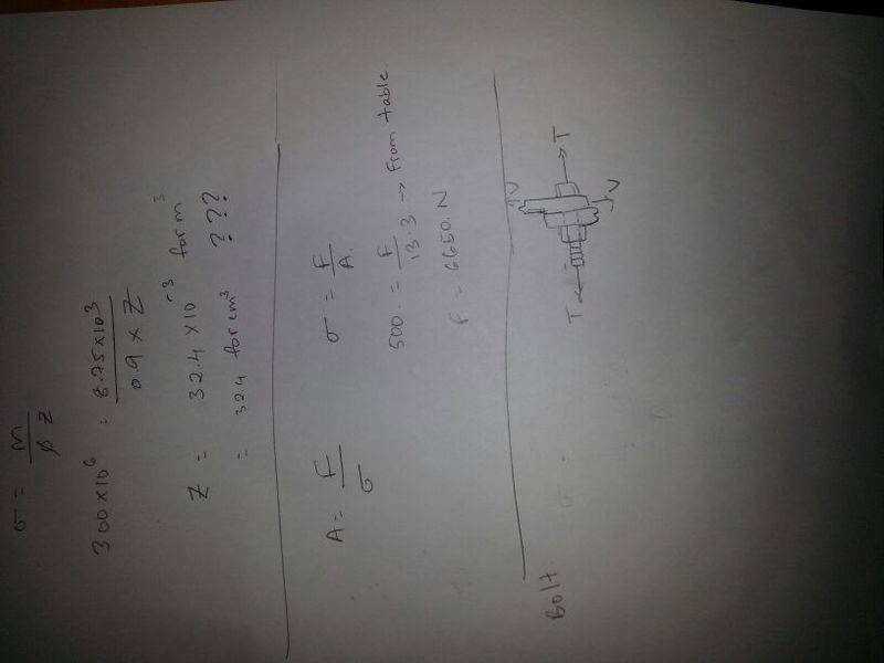

x_eyeless_x
need to calculate cantilever beam analysis, column analysis, pivot pin analysis, ram pins analysis
the attached pdf has the picture of the crane i intend to use.
Tensile stress, σ = F/A
General bending equation: M/I = σ/y
Moment of inertia for a rectangular section: bh^3/12
Moment of inertia for a circular section: Ix = Iy = ∏D^4/64
Moment of inertia for a hollow circular section: Ix = Iy = ∏(D^4-d^4)/64
Shear stress on a bolt in double shear, σ = F/(∏/2)D^2
Torque = Fr
the pics attached shows the attmept of my calculation.
View attachment RC1000.pdf
