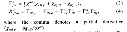

Another question: how does the partial derivative work here?
I would have interpreted this as saying ##g_{\alpha \beta , \gamma} = \frac{\partial g_{\alpha \beta}}{\partial \gamma}## but clearly this is not what the author wrote. What am I missing here?

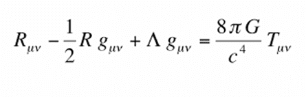

The author talks about needing to derive the Riemann, Ricci, and Einstein tensors. In the EFE, I know that the Ricci tensor is the ##R_{\mu \nu}## term, but which ones are the Riemann and Einstein tensors? I'd guess that ##R## is the Riemann tensor, but then I'd be at a loss as to which is the Einstein tensor.
For reference:
1v1Dota2RightMeow said:
In the EFE, I know that the Ricci tensor is the RμνR_{\mu \nu} term, but which ones are the Riemann and Einstein tensors?
The Einstein tensor is the first two terms on the LHS of the EFE, i.e., ##R_{\mu \nu} - \frac{1}{2} g_{\mu \nu} R##. The ##R## is the Ricci scalar, i.e., ##R^\mu{}_\mu##. The Riemann tensor doesn't appear in the EFE.
Oh interesting! That's weird then because the author specifically mentions all 3 of them in one sentence. Seems kind of awkward.
The Riemann tensor is a four-index tensor that describes the curvature of spacetime. It doesn't explicitly appear in the Einstein field equations, but the Ricci tensor (##R_{\mu\nu}##) and Ricci scalar (##R##) are both derived from it.
It is what the author wrote. What you have written doesn't make sense.
##g_{\alpha\beta}## is a function of ##x_0##, ##x_1##, ##x_2##, and ##x_3##. The notation ##_{,\lambda}## means partial differentiation with respect to ##x_\lambda##, just as the author says.
I strongly recommend that you take a few hours to read through Carroll's whirlwind tour of tensor notation: https://preposterousuniverse.com/wp-content/uploads/2015/08/grtinypdf.pdf
[Edit: when I first posted this, it was on a browser that didn't render Latex properly, so some errors in the Latex slipped by. I've fixed them now]
Yes, but he doesn't say they all appear in the Einstein Field Equation. Nor does he say the Riemann tensor doesn't, but that's because he assumes the reader already knows that it doesn't. Bear in mind that the paper in question is written for relativity experts, so there is a lot of background that the reader is assumed to have--more like A-level background (graduate) than I-level (undergraduate).
