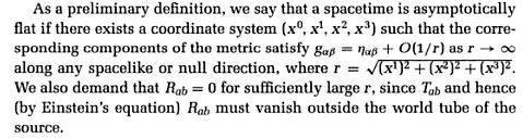

Julian M said:
In other words, to be asymptotically flat one must be able to reach flatness in all directions not merely from any point? But what constitutes a valid "direction"
Aha. A search for the definition of asymptotic flatness turned up something useful in General Relativity by Malcolm Ludvigsen (http://books.google.co.uk/books?id=...-kK&dq=define "Asymptotic flatness"&pg=PA115", see also attached quote JPG; copyrighted material, minimal quote) where he says that a spacetime is flat if the metric tends to Minkowskian along any spacelike or null direction. (He does however go on to say that the geometric definition of asymptotic flatness is "a whole branch of relativity in itself"... this is seriously non-trivial.)
However, keeping it simple for the moment, in the case under discussion, the wormhole joined universe(s) (i.e. universe(s) + wormhole) is/are not asymptotically flat because nowhere along the null direction around the wormhole throat (i.e. the path of a light ray that circulates around the throat) is spacetime Minkowskian.
It seems to me therefore that this suggests not that ADM Mass is separately conserved in the universe(s) to either side the wormhole but that the ADM Mass cannot be defined for this topology.
Whilst it might seem that each universe is separately asymptotically flat, to reach some null infinities one must pass through the wormhole. If there are two universes one might say either
A) that each "is" a universe - in which case along certain null directions there is no infinity (??) because the other end is not in the same universe and therefore that the ADM Mass cannot be defined, or
B) that the joined universes (less wormhole) taken together constitute a spacetime - in which case all null directions reach infinity (even those that pass through the wormhole) and the ADM Mass is defined for the union of the two, which seems to lead to a contradiction when we consider a mass traversing the wormhole: while the mass is within the wormhole it is not in the ADM Mass conserving spacetime at all, so somehow that spacetime has lost mass whilst at the same time conserving it; this would tend to suggest that the ADM Mass is not definable for the union of two spacetimes that are not joined by a mass conserving (at least ADM Mass) region
In case A, without ADM Mass mass can't be ascribed to a wormhole mouth because it isn't defined for either universe. And in case B, ADM Mass can't be ascribed to a wormhole mouth because it isn't defined for the union of the universes.
Having already dismissed the case of U+U+W above, it would seem that there isn't a meaningful ADM Mass for this topology (however, with nowhere to go common sense - which may be unreliable - suggests that U+U+W should conserve mass... which leads to the question: what is the appropriate equivalent of ADM Mass for this topology?)
The only downside to all this is that Visser et al are perfectly happy with ADM Mass in this context...
How do these arguments stack up with you... how do I reconcile myself to the POV of Visser et al?

I agree with Visser that a wormhole spacetime can have two asymptotically flat regions, that each region separately defines an ADM mass, and that Figure 11.3 is a Penrose diagram for a wormhole spacetime. Over the last few days I have been looking at Ludvigsen (I got my copy shortly after it was published) and several other books that are on my shelf.

Plan of action:
1) write down a specific wormhole metric;
2) use metric and (something like) Ludvigsen's preliminary definition definition of asymptotic flatness to find the two asymptotically flat regions;
3) use metric and (something like) equation (11.64) in Visser to find the ADM masses.

Yes, I understand that the Bondi-Sachs energy is most often used in considering radiation, so from POV of a static spacetime they would be equivalent.
I do see that there are two asymptotically flat "regions" in the broadest sense of the term "region" (for a pair of conjoined universes): in the sense that there are two values for l ([tex]\pm\infty[/tex]) at which spacetime is flat, but I am hoping that your calculation would show where the boundaries are and established why the regions meet the criteria for flatness required to define ADM Mass.
