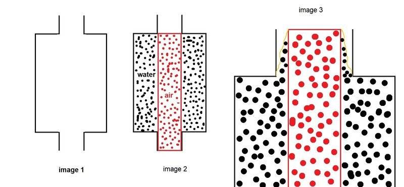

Hey, I am from Turkiye, 17 yo and studying at high school. I have a project and would be better to know whether or not my project will work. I tried to draw it simply on paint and will tell you about some important points of it.
Image 1 is the main body, its something solid and waterproof. It has holes at the top and bottom.
Image 2, the red thing is a tube full of air. Its top and bottom is tied to the main body with a waterproof cloth or something else water proof.
Image 3, its a close look to what I am trying to tell above. The yellow things are waterproof cloth, to prevent water leak while red tube is moving vertically.My question is: Can the red tube move upward when its released in Image 2 position ?
Yes, a sealed tube of air will float when submerged in water and released. As long as the tube is relatively lightweight of course, and not tied down by the cloths. Just leave some 'slack' in the cloths.
Yes, the red tube will be soo lightweigted when compared to the lifting potential of the air it keeps in. Yes the cloth will have enough slack to allow the tube to rise.
Hmmm. I just realized that the bottom is also sealed by the cloth so that there is no way for water to get underneath the tube. I'm not sure it would float now. @berkeman what say you?
Yes, both top and bottom is sealed with cloth. So there is a water pressure on the clothes and tube have to overcome this pressure too.
Hard to say. If the cloth goes under the air tube, it's probably rough enough to allow water to get underneath and start the lifting process. No idea what the mechanism is for, though.
Well, if it's sealed to the tube, then there should be no way for water to get underneath the tube. In that case I don't believe that it would float.

This proposed experiment is a really difficult mix of real and ideal components. If there is not way of water getting to the bottom face of the air-filled tube then there should be no upward force. It's a bit like when you stand in thick mud with Wellington Boots on and you can't drag your feet out. That 'suck' is all about greater air pressure down on the upper face of the soles, via the gaps between leg and boot and no pressure on the lower face. But, given time, water can seep in underneath and provide upward pressure.
How good are your seals? Only you (@TurkishFR ) can find that out.
Thanks. I would like to be able to build such a thing to test it but I really have no idea how to build it.
Since there is a hole in the bottom of the outer container, even if water can leak under the red tube, it can't exert more than atmospheric pressure at that level (- allowance for weight of the thin film of water) The tube must slide down under its own weight, unless friction keeps it in place.
That's my interpretation, but I must admit, I don't understand the role of the cloth, so I may not be seeing it right.

Get a plastic bucket with a lid. cut a hole in the top and bottom, sized for a pipe to pass through. Instead of cloth, cut up a plastic sheet and duct tape it to the bucket and pipe. You'll need to support the bucket in a way that the underside is clear and support the pipe during construction and filling.
Fill the bucket, close the lid, and drop the pipe. Do this outside so that when the pipe drops straight through and rips off the plastic, the water doesn't spill on anything important.

There is a problem with your logic there. There will be an upward pressure on the bottom of the top bit and an equal downward pressure on the top of the lower bit.
You can work out what your experiment should do if you just consider the pressures and weight involved. Would there be any net upwards pressure from the water, for instance? (Think like a Real Physicist. :smile:)

Unfortunately there is a well known perpetual motion machine rather like this, where a series of floats on an endless belt enter a tank of water from beneath, via some sort of flap.

Thanks folks. It looks like that was what the OP was trying to ask about. Since the subject is not allowed on the PF, this thread is now closed. :smile:
