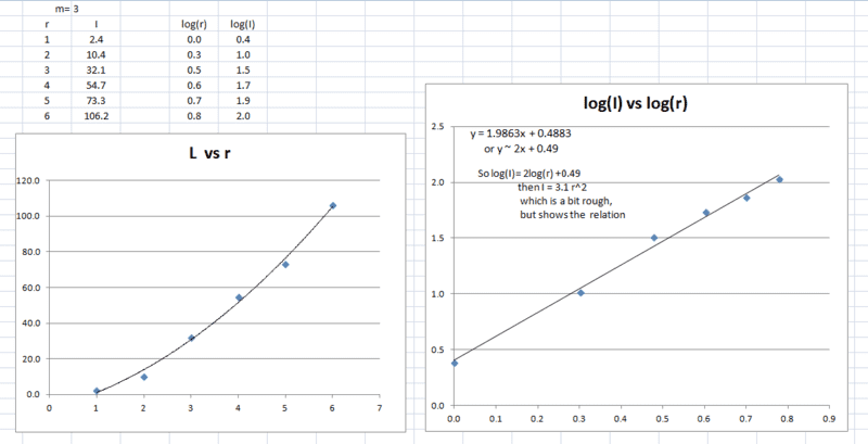

its OK its a lab that's already completed. It was time sensitive question that's why I thought I would ask the exact issue I was having but it turns out I just needed to square the R value to linearize the plot. (because I = .5MR^2).. That was the problem i was having: How to linearize moment of inertia vs radius plot Thank you for all the help.

I'm not a mathematician, but my old maths teacher told me that log-log works for most equations I'll meet.
If you expect it to be x, x^2, x^3 , 1/x , √x , etc. then it will tell you which.
This is just some made up data:
BTW the lines were sketched by Excel just for speed and convenience. I don't like that and would get a better line by hand, when I know what answer I want ! Only joking, but humans really can do better, because we know the 0,0 must be on the line even though we can't collect that data.
But (0,0) does not seem to be on your graph. For "standard" regression we have that ( x-bar, y-bar) are in the least squares line of best fit.
I don't know how to measure that data point: zero radius is impracticable.
I should have simply selected the option in Excel to force the line through 0,0 as suggested by MFB. I only thought about that when I noticed Excel had done it wrong and I forgot that it has such an option.
