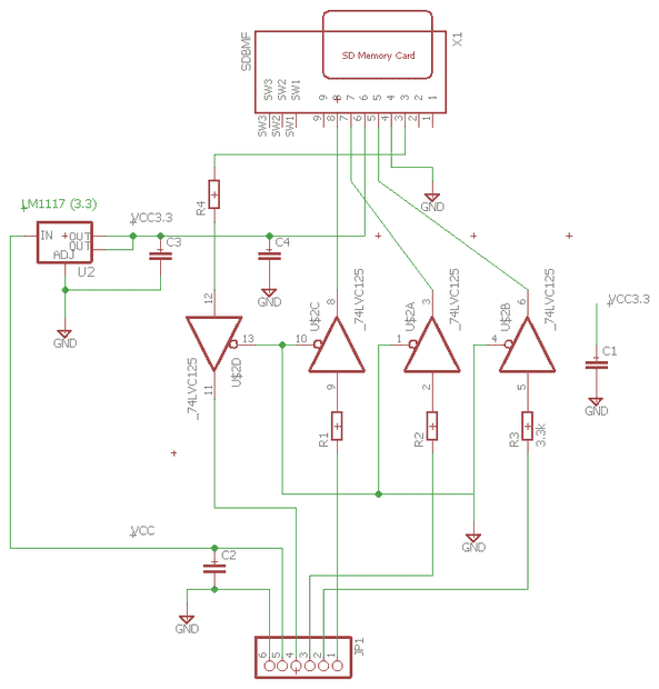

All I have is this sad attempt at reverse engineering the SD card Arduino add on board I used in the PoC device. Just realized connections at the bottom are not marked - these are GND, VCC (5), MISO, MOSI, SOC, SC, just SPI and power. All resistors are 3.3 kΩ, not sure about capacitors (my meter displays some strange numbers), but I assume C1, 2 & 4 to be standard decoupling 100 nF, not sure about the value of C3 - if I read it correctly LM1117 specification calls for 100 μF, but the one on the board is definitely much smaller (I guess currents used are so small 100 μF would be an overkill).
But from what you are writing it sounds like copying it can be safer than trying to redesign with other elements, apparently I miss a lot. Not that I am surprised ;)
It looks like the resistors are attempts at back-terminating those lines, but 3.3k is a pretty strange value to use. The back-termination resistor should add to the output resistance of the drive gate ##R_{out}## (which is usually in the 10s of Ohms) to equal the characteristic impedance ##Z_0## of the trace over the ground plane (the ground plane should be the inner layer adjacent to the top layer where the trace is).
The connector is worrisome -- I guess I missed the fact that this would be an add-on card and not a new PCB. Is that true? running fast signals through connectors causes discontinuities in ##Z_0## that can cause that pesky ringing that can affect signal integrity. Are you doing your own PCB design for this project? The back-termination resistors should be right at the drive gate output if so, but again only if you are going a few cm to the input to the next gate/IC (or going through connectors).
BTW, will this SPI connection only be used to access the SD Card, or will it also be used to access other SPI devices via separate Chip Selects? If MOSI stars out to multiple devices and MISO is coming from multiple devices, that creates issues for the signal integrity also. There are solutions in the PCB layout if that is happening on your board.

No no, that's just what I used to test the idea. Final thing is planned on a single, matchbox sized PCB. No other SPI devices will be present (or at least that what I tested and what I plan for now).

I thought these resistors are just for protection and limiting currents, I remember such solution suggested in some DIY projects

BTW, are the inputs to the SD Card 5V tolerant? If not, you can't just use a 5V CMOS VHCT gate to drive them. You would need some buffer gates for the downlink signals that could run on 3.3V and had 5V tolerant inputs.
There are about a million devices that can do this, so it's hard to answer. Have a look at the digikey.com site and search for "level shift ICs" or maybe "level translators". They have nice search menus that let you focus on what you care about.
I would probably look at the TXB0104 parts. They might be overkill, but they are cheap (by DIY standards), readily available, flexible, and easy to use. Good to have around the lab for next time, too.

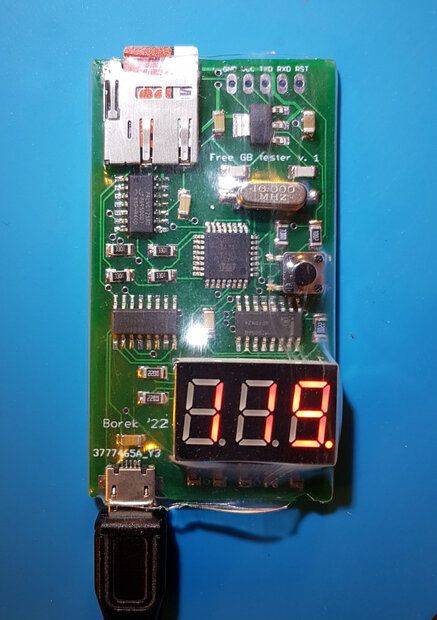

I am not entirely happy yet, but it works (and is easy to reprogram, so there is place for at least some code improvements).
This card has 119 GB free space. Take it out, plug in a next one, press the reset button, wait few seconds for the result - and so on.
Several things are wrong: SPI doesn't work at full speed (@berkeman - probably should ask you for taking a look at the PCB; but it actually doesn't matter much, looks like I am limited by the card speed, not by SPI - still, it worked at 16 MHz on the breadboard, now it works at 4 MHz). I don't like the level shifter (I used just the copied solution mentioned earlier, I wanted to try TXB0104 @DaveE suggested, sadly I couldn't buy it here for a reasonable price - I don't need hundreds, I don't want to pay $$$ for delivery). And finally - shift registers for display are unnecessary, I have enough unused legs on the μC to to avoid 595s, I just blindly followed the first idea.
Oh, and don't bother telling me I don't know how to solder, I already know that :wink:
