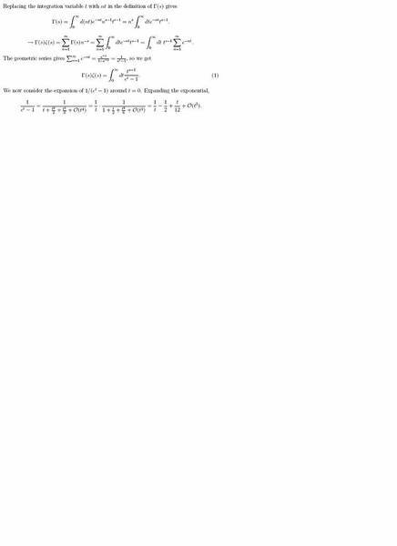

How do you justify the last inequality?
Sorry. I mean equality.
Cool. I knew that 1/(1+t) = 1 -t + t^2 -t^3 +t^4. I didn't know it was true when you replaced t with an arbitrary function of t.
Is there a quick way to prove that?
This is not a statement about the function f, it is a statement about the number f(t).
