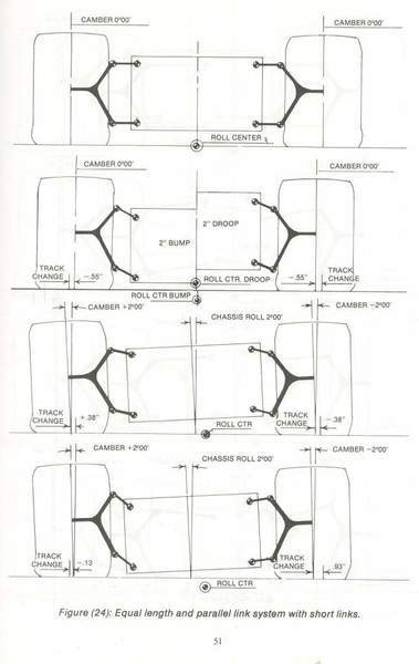

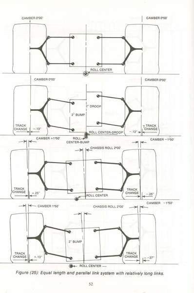

So are we concerned about the location of the roll center when at ride height or in dive?
I have been told not to go too low with a cast iron head engine and harder tires...(3.5-4.5" range)
How is roll center location requirements changed by going to a big bar?
I assume the chassis won't roll as much, so does the outside tire still get loaded?
Need to move the roll center more to the right ?
  • #377
Rick..am in Detroit on business...but..ifin I remember right..the standard reason for not going low on RC is to keep the lever arm ( moment) short..too long an arm means more spring rate to handle the extra leverage. With iron heads 3.5 inch is about max length. This whole theory assumes we have centered RC.
I never put much stock in this and I only looked at camber gain...Low RC means minimal camber gain. get the RC height and location right then tune in with springs and ARB...don't change Rc to accomdate a stiff ARb..it is the tail wagging the dog...same with springs
We need some body roll to plant the right front tire. we do not want ogo over board on roll though. I would look at roll center at ride height and location after one inch compersion..1 1/2 inch max..the RC migration is important. If you can start out at 3.5 inch RC height and 3 to 3.5 inch offset to right and end up between 2 and 3.5 offset to right...and the RC under where you started...you should be close. the reason we have the right side off set is to get enough weight to plant the rt ft tire andsince we have 55 to 60 % of car weight " rolling thru " the RC with this location...we get enough weight without going wild with body roll. If you run too stiff a roll bar and get zero body roll the springs have to do all the work and you are getting into the solid axle converion kit mode.
One more thing..beware of too much dive..you should have 1 1/2 to 2 inch dive max. Most super late models are running +/- 1.5 inch travel...if you think about it, 3 inch travel on a 600 pound spring means the spring is 1800 pounds with 3 inch compression...no way..
thats about all i can post not having my notes..
  • #378
So the reason for the question is that I am aiming for a lot of dive, so since the center of gravity and RC go down at the same time, the lever does not get longer...
But, since the dive will likely occur before cornering, should the "dive" roll center be looked at more than the static one?
Crank height is 13.5" so C of G will be around 19 "...
  • #379
Rick..again I apologize for note having my notes..I think we use the camshaft location for the CG as it is pretty good average relative to the heads...
the CG will dive a bit but the RC will migrate and I have seen the RC acting like a wild weasel..all over the place and yes..the distance can vary a whole bunch. That is why the computer program is so important..plus you can see camber build at each segment of front end dive and roll. This situation is made more difficult if you use two differing lengths of upper control arms.
So you pretty much have to know RC ht and offset at ride ht and at max dive..I think the first inch is critical as this is when things happen..after that the transferred weight has done the deed and other factors are key.
I would concetrate on keeping the nose down on the straights ..that will pick up some aero and thus speed...and not doing so much dive in corners..what is the point of a lot of dive??

  • #389
Before we get into layout of the ideal suspension ( no such thing) ..lets look at the double wishbone layouts.
Equal length and parallel links - this is the hot set up- minimal camber change but..the track width changes. Note the change when using short lengths. The longer links still change the track width..though minimal..the whole draw back is the width of the race car and this set up is real hard ( if not impossible ) with front engine stock car...there is just no room. Note the Roll Center and location. The min camber, and the camber build and track width change during roll plus bump and RC location/ height is my reason for thinking that this is the hot set up. my opinion..
