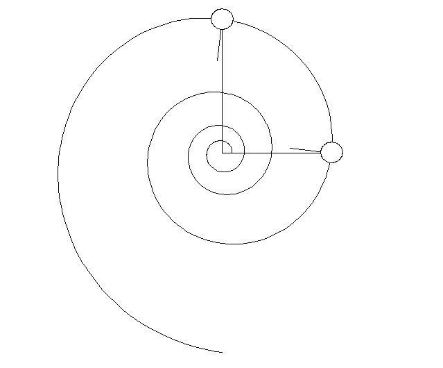

I have problem to see clearly the case of rotation of a body about a point with decreasing radius.this can be viewed as a body being rotated about a point with the help of a thread which passes through a hole in a disc and the thread is being pulled to apply a tension and gradually to decrease the length of the thread.I have attached a word doc. to have a clear pic. about it.It can seen that here that the instantaneous velocity has two components ,one perpendicular to the radius & other along radius. The tension is along the thread or radial.
there are some points to be noted.
1 .the tension being perpendicular cannot do any work on the perpendicular comp. of velocity & cannot change its magnitude.
2.there is no torque about the center as tension is radial. So, angular momentum should be conserved.
But the problem is angl. momen. is rXp . or " r*mvperpendicular".
as angu. momen. is constant so r*mvperpendicular should be constant.
Then if r decreases so then vperpendicular must change. And it means that the perpendicular comp. of velocity changes ,which violate the 1st point.
Quote Quote by Doc Al View Post
But as the thread is pulled, the velocity does develop a radial component and thus work is done. (The object spirals inward.) The speed of the object increases.
Attached is an image that shows this situation. The short lines are perpendicular to the spiral path. It's also possible to reduce the force used to pull the string, in which case negative work is done, the object spirals outwards and the objects speed decreases:

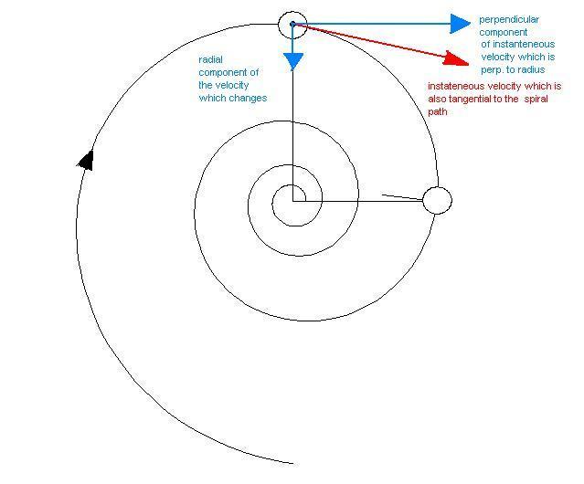

thanks for your replies .All the statements made by you are absolutely right. Surely the speed of the revolving body will increase as the tension is doing work on it. The attachment given by "rcgldr" is OK. but have a look in this attachment below. the instantaneous velocity is (here in RED) tangential to the spiral path that the body makes. Now we resolve it into two comp.. one along the radius(in BLUE color) and the other perpendicular(in BLUE color) to it. ofcourse the ,the tension is acting along the radial direction and it doesnot have any comp. along the perpendicular component of the instantaneous velocity. So, the tension will do work on the radial velocity , as usually the net speed will increase .But .... the perpendicular component of the velocity will remain same. that is what I meant to say. The perpen. one will remain constant.
But the problem is angl. momen. is rXp. or " r*mvperpendicular".
Then if r decreases so then vperpendicular must change. And it means that the perpendicular comp. of velocity changes.

#6
Jun29-11, 05:32 AM
HW Helper
P: 6,925
Quote Quote by Multiverse View Post
Only for an instant (zero time). As the object moves, the direction of the "perpendicular" component of velocity is constantly changing, so what was the radial component of velocity at one time becomes part of the perpendicular component at a later time.
angu. momen. is constant so r*mv should be constant.
It is constant. If the radius is decreased by 1/2 and then kept constant, then the speed of the object doubles and the tension increases by 8x. Some of the math (which shows work done equals change in kinetic energy) is included in post #3 of this thread:
the direction will change , but magnitude should remain same as the tension cannot change the perpendicular component of the velocity because tension is always perpendicular to the per. comp. of velocity at any instant.
As I mentioned before since the direction is changing, then the radial component later ends up as part of the future perpendicular component. Take the case where the radius stops decreasing and becomes constant. If the new radius is 1/2 the original radius, then the objects speed is doubled, and all of that speed is perpendicular. Now take the case where the string is pulled inwards very slowly (assuming no losses here), where the spiral path is nearly circular. When the radius is 1/2 the original radius, the speed is doubled, and almost all of that speed is in the perpedicular component (because of the very slow radial movement).

#10
Jun30-11, 02:30 AM
P: 9
As I mentioned before since the direction is changing, then the radial component later ends up as part of the future perpendicular component....
may be you are right,but ,truly speaking I am not getting you. I am just a beginner. It will be my privillage if you can just ellaborate this concept and clear the errors in my thinking.You can suggest some links also .
I saw this link . "the involute of circle " ,this stuff really helped me to do one problem or two in Irodov. but even after solving them correctly ,I am confussed.
What exactly is the problem? You are right, no work is done in the tangential direction. That is why angular momentum is conserved and the speed must increase as the radius decreases. What part of this process is causing confusion...
Sir, here the tangential velocity to the spiral path is the instanteneous velocity. It has two components -'one along radius and other perpendicular to it'. The perpendicular component of this instanteneous velocity is not the tangential velocity (which is in tangential direction to the spiral path).
So, tention , being perpendicular to this perpendicular component, can change its(perpendicular component's) direction but not the magnitude ofcourse.
So, clearly
1.Angular momentum is constant .
2.the Vperpendicular is constant in magnitude.
Now my confussion is:-
Since, Angular momentum is constant,its direction and magnitude both must remain constant.
The expression for angular momentum is rxV .
ignoring its direction which always remains same,it can be written simply as
........................magnitude of angular momentum = r.Vperpendicular.............
Since,its magnitude is also constant , if 'r' decreases then Vperpendicular must also change.
This is my confussion because Vperpendicular is constant (as you also agreed) .
This miraculas result is really disturbing me.
Vperpendicular is constant.
The string is causing the object's direction to change as well as the object's speed. The velocity tangental to the path of the object as the string is pulled inwards is increasing. The "perpendicular" component of that velocity will also increase over time. This is because as the direction of the velocity changes, so does the direction of the component considered to be "perpendicular".
For example, there's a moment in time when that direction of the perpendicular component of velocity is horizontal. Prior to that moment in time, there was a period of time when there was acceleration in the horizontal direction. Only at the instant of that moment in time is there no acceleration in the horizontal direction. Immediately afterwards, there will be a decleration in the horizontal direction because the direction is being changed towards vertical (assuming a spiral like path).
As long as the string is being pulled inwards or released outwards, the velocity and the components of that velocity will be continously changing.
