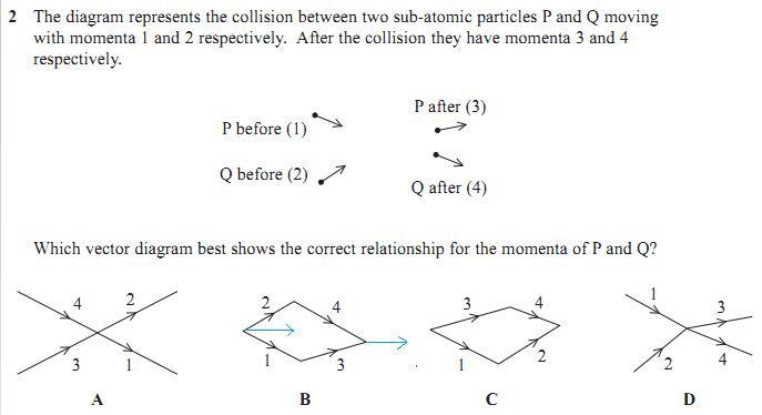

1. The problem statement, all variables and given/known data
see attached image
2. Relevant equations
3. The attempt at a solution
So I know as it is a VECTOR diagram it must either be B or C
So I checked that 1, 2, 3, 4 all pointed in the correct directions and they do in both diagrams.
I chose B (but at random) and the answer was C.
Why is the answer C?
thanks

Hi jsmith!!
Use the conservation of momentum, this tells you the initial total momentum should be equal to the final total momentum. In which of the options, do you see this??
momentum is consereved in B??
How is momentum conserved in B
May31-12, 04:42 AM   #8
Quote by dimension10 View Post
resultant momentum of both is in the same direciton, no?

In classical mechanics, you have ##m_1v_{1i}+m_2v_{2i}=m_1v_{1f}+m_2v_{2f}## but that does not hold in the question, so I think it is a Quantum mechanics question...

Uh nope, it isn't. And you can't be sure about the direction in B as the exact magnitude and direction of original aren't given.
Also, direction isn't the only necessary factor. The magnitude remains same too. Observe C carefully.
I just reaslied that i have to apply head-to-tail rule
if I apply this it ALWAYS works for ALL questions that have bothered me in the past
Yes!! That's it!

Then I don't think I understood the question properly. What I understand of it is:
$$v_{1i}=1$$
$$v_{2i}=2$$
$$v_{1f}=3$$
$$v_{2f}=4$$
$$m_1,m_2=\mbox{Constant}$$

You didn't read the question properly
1, 2, 3, 4 are the momenta before and after collision, not the velocities.
