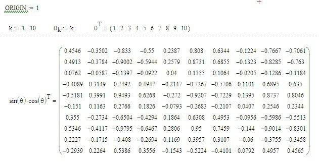

Well, they seem to agree with my Mathcad-generated results, if that's of some reassurance.
But i have no idea how to do the same thing with a loop-free script.
Try something like:
k = 1:10;
A = sin(k)' * cos(k);
note the single quote mark, the transpose operator. The creates a vector, k, with values 1 to 10, the sin and cos functions operate over vectors, resulting in 2 vectors, the sin is transposed and the resulting matrix multiplication is equivalent to the first loop method.
You can use just k as the number of k and m elements are the same.

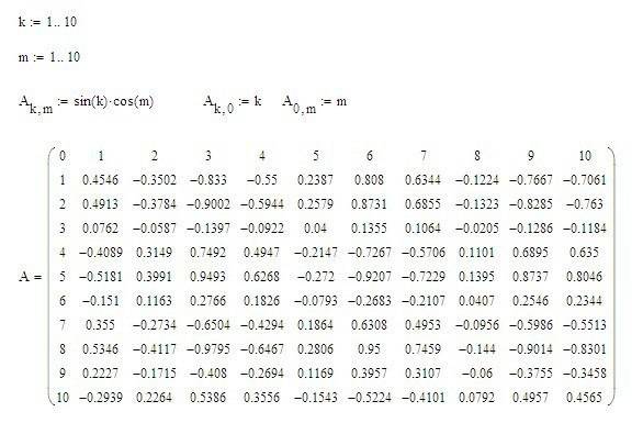

Forgot to add, image showing proof of pudding in Mathcad.
