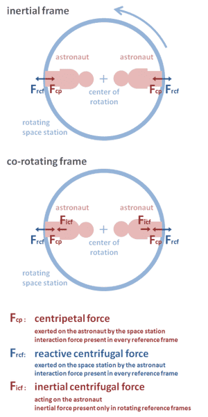

Andrew Mason,
In A.T.'s drawing below, do you disagree about the existence of any of the forces, or is your disagreement entirely about the labeling?

Quote Quote by DaleSpam View Post
It seems to be about labeling and the problem that: You can have an individual force acting outwards and inward acceleration of the CoM of some arbitrarily chosen part of the system. But at the same time that outwards force can have real, physical outwards effects, like outwards acceleration/deformation of some other arbitrarily chosen part of the system.
The best way to avoid this conflict, is to ignore all the effects the force might have on arbitrarily chosen parts, and simply consider what is independent of how you split up the system: The force's point of attack and direction. This leads to the label "centrifugal".
No, that is not what I am saying at all. A dent forms due to stresses in the material. In dynamics there can be stresses due to the floor's own inertia, but any stresses attributable to the astronaut will be through the reaction force.
How do you propose that the astronaut's inertia will cause stress in the material? Please provide a reference to support the claim.
A dent signifies that there has been movement. If the dent is due to a force overcoming stress, the motion results from that force exceeding the stress momentarily. That can never happen here. My point in using the jello was to eliminate the force and the stress and show that there would be a dent in the jello that essentially traces the inertial path of the astronaut.
Our disagreement is not that there is a force between the astronaut and the space station. We don't disagree on its direction either. We just disagree on what that reaction force does. You say it is just a force that results in centrifugal tension in the space station. I say that it actually accelerates the space station in the direction opposite to the direction that the astronaut is accelerating. In other words, it accelerates the space station toward the centre of rotation.
My position is that by calling it a centrifugal reaction force giving rise only to a tension is incorrect and it also makes it extremely difficult to distinguish from the fictitious centrifugal force. The centrifugal force or pull from the outside is postulated as the source of the tension in the space station.

DaleSpam
#84
Feb4-13, 12:04 PM
Mentor
P: 17,526
Quote Quote by Andrew Mason View Post
Sure, Newton's 2nd law.
Why not?
Even in jello there is a reaction force. Jello has a very low yield strength, so the force will be small, but it is still that reaction force which causes the deformation of the Jello. By using jello you have made the reaction force small (not zero), but you have also made it particularly sensitive to the force.
OK. That force that we both agree exists is called the "centrifugal reaction force". It is how that term is defined. You may not like the name, and you may have excellent reasons for disliking the terminology (e.g. for extended bodies a centrifugal reaction force can cause centripetal acceleration), but nevertheless that is the standard terminology.
I don't disagree about the acceleration which falls under Newton's 2nd law (although in A.T.'s example the space station's COM is not accelerating).
I disagree only with your interpretation of Newton's 3rd law where you try to claim that the 3rd law reaction to the centripetal force on one astronaut is the centripetal force on the other astronaut. All of the remaining discussion has been about your attempts to justify that interpretation, either by re-defining Newton's third law with reference to his use of the word "action" or by asserting that the centrifugal reaction force does not have any physical effects besides centripetal acceleration.
I think that it is clear that the reactive centrifugal force exists in some cases, in those cases it is the 3rd law pair of a centripetal force, it is always a real force, it exists in all frames and can do all of the things that you would expect of a real force including material deformations and other such things.
I also agree that the terminology can be confusing. It is clearly a topic that many students struggle with. Personally, I don't even like the "action/reaction" terminology, but it is out there and people should know what it means.
A.T.
#85
Feb4-13, 12:34 PM
P: 4,201
Unless you include the other astronaut in the space station. So it depends on an arbitrary definition of objects, what the "effect" on an object's COM might be. That's why it is not a good idea to base a general naming on some object’s COM acceleration. The logic behind the centrifugal-name does not depend on how you cut the system into pieces.
And if more forces are acting, it is even more difficult to attribute a particular effect, to a certain force. That's why it is not a good idea to base the naming on effects in general. The logic behind the centrifugal-name does not depend on other forces, and what effects they might cause together.
I don't see the significance of the point of attack.
It's a naming convention, not a matter of great significance. See post #85 for my reasons to prefer the common convention over yours.
The sum of the mass x (centripetal) acceleration of each of the two parts = 0.
This is not generally true. If you take two parts which are near each other or two parts which are opposite but not equally massive then their change in momentum may not be equal and opposite.
5. Since the force applied by the space station to the astronaut = the mass x the (centripetal) acceleration of the astronaut, the equal and opposite force applied by the astronaut to the space station = the mass x (centripetal) acceleration of the rest of the space station = sum of all the forces acting on all the parts of the rest of the space station.
This is true if you consider the opposite astronaut to be part of the space station (which is valid). In that case the centrifugal reaction force applied by the right astronaut to the space station is indeed equal to the mass x centripetal acceleration of the "space station & left astronaut".
The statement is not true if you consider the opposite astronaut not to be part of the space station (which is also valid). In that case the centrifugal reaction force applied by the right astronaut to the spact station is not equal to the mass x centripetal acceleration of the space station.
