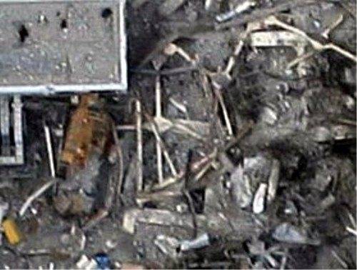

OnlyOneTruth said:
I'll start a new attempt to raise awareness for an annotated picture posted before:
The annotation characterizes the curved deformation as damage from heat. Isn't that plausible? Do we have any reliable information on the sequence of events in No4 (fire before/after explosion)<..>
I don't think that is a plausible damage from heat.
Allow me to draw your attention to a possible suspect at the foot of the building (see attachment). It is found at the scene of the crime, in a plausible position after an assumed hammering of unit 4's north side. It appears to be a boiler tank or something of that sort, about 10 meters long, about 3 meter in diameter. It appears to have been blasted. And, perhapos significantly, it appears to be lying on top of pieces of unit 3's roof construction.
Astute observation. The tank is on top of ground debris, but that doesn't necessarily confirm it came from Bldg 4. But the path of debris from the hole in the side of Bldg 4 plus the impact damage to the north side of the smaller building structure and the final resting place would be consistent with the tank being a projectile.
These hi-res views weren't available when the causes of the damage from the initial north face photograph of Bldg 4 was posted.

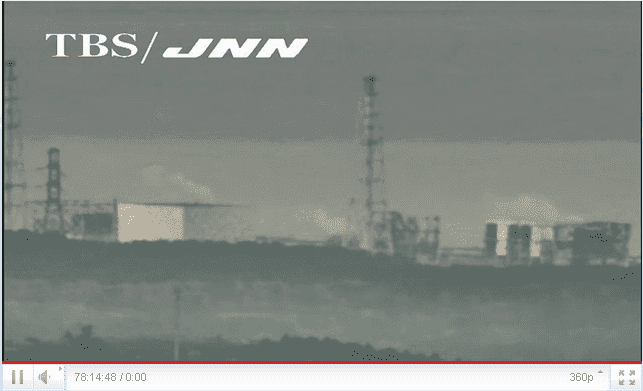

However, in defence of the suspect object, it would seem evidenced from a Digitalglobe satellite photo taken on March 12th (detail attached) in which the object can be seen lying in it's present position, that this object has absolute nothing to do with any of the later events in unit 3 and 4. Oh well.

NUCENG said:
So whence cometh the damage to Unit #4 exterior? There appears to be photography showing Unit 4 intact after Unit #3 exploded. But look at Unit 3 in those pictures. There is concrete slab siding on the ground floor and two floors of open concrete support beams and girders. In the pictures showing Unit 4 damaged the seems to be another floor missing from Unit 3. The damage to Unit 4 is bent away from unit 3. Is it possible there was a second explosion at Unit 3 that caused the damage to Unit 4?
I think the following image argues against this admittedly intriguing idea:
http://livedoor.2.blogimg.jp/dqnplus/imgs/6/d/6dffb5e9.jpg
That was on 3/14, after #3 blew up but before #4 did.
The damage to building #3 seems largely complete at this point already.
#4 has no visible damage yet.
Zoom in of the above:
Compare with the next day, after whatever had happened to #4:
[URL]http://www.tepco.co.jp/en/news/110311/images/110316_1f_chijou_1.jpg[/URL]
They look about the same to me...
