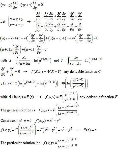

how can we solve this differential equation?
(ax+y)∂f/∂x + (ay+x)∂f/∂y =0 with this condition: if a=0 then f(x,y)=x^2 - y^2

[tex]df=\frac{∂f}{∂x}dx+\frac{∂f}{∂y}dy[/tex]
At constant f, [tex]\frac{∂f}{∂x}dx+\frac{∂f}{∂y}dy=0[/tex]
Or equivalently, [tex]\left(\frac{∂y}{∂x}\right)_f=-\frac{(∂f/∂x)}{(∂f/∂y)}[/tex]

The change of variables (in attachement) leads to a very simple PDE :
