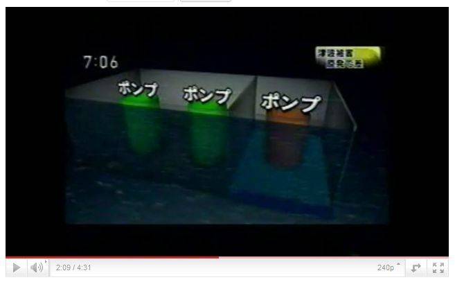

I wonder how enough seawater pumps at Daini unit 3 could remain safe after being flooded by the OP+6m ~ OP+14m wave reported and depicted on dramatic pictures at http://www.tepco.co.jp/en/press/corp-com/release/betu11_e/images/110409e10.pdf, if they are located outdoors. How can we explain the Daini unit 3 miracle ?
The following attachments are from , a video explaining how the Tokai NPP (located further South in Ibaraki prefecture) survived the March 11th tsunami. The video says that the seawater pumps are enclosed in "more than 6 m" high walls, while the tsunami wave was only "more than 5 m" high. Two pumps survived. The third pump didn't survive because its wall was still under construction and not finished.
Tokai NPP's pump protecting wall is also depicted on a diagram at http://www.asahi.com/photonews/gallery/infographics/110330_toukai2.html and on photographs at http://mytown.asahi.com/areanews/ibaraki/TKY201104190562.html (according to that article, the seawater pumps are also providing cooling for the emergency diesel engines ; One diesel engine stopped because the seawater pump for that engine was flooded through a hole in the wall. The reason for the existence of the hole is that the wall was under construction ; If the wall had been 70 cm lower, the Tokai NPP might have had the same destiny as Fukushima Daiichi)
