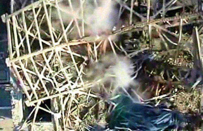

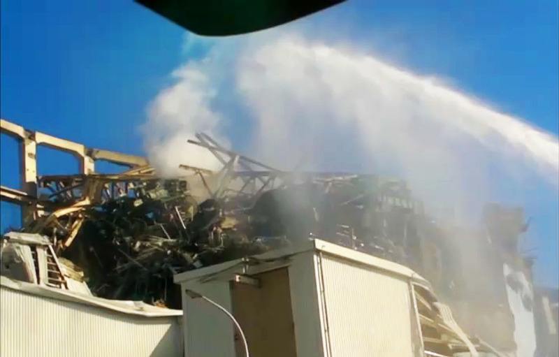

These two photos ...
are linked from the Tepco handout page. Above the links the page says:
"A picture taken from the concrete pumping vehicle, the spent fuel pool, Unit3, Fukushima Daiichi Nuclear Power Station
(pictured on April 14, 2011)"
The picture to the left I cannot recognize as having anything to do with unit 3 at all, nor indeed, a spent fuel pool. I am not sure this photo is even from the vicinity of unit 3.
The picture to the right appears to me as something that could very well be from unit 3, however that would be from the north end of the building, not at the spent fuel pool, which is situated in the south end of the buiding
I wonder if anyone might have been more successful than I, in an effort to locate the motives of these two photos?
For comparison, here's how the roof floor of unit 3 with its SFP (the greeny area) looked in Tepco's skyview from April 15th:
[URL]http://www.tepco.co.jp/en/news/110311/images/110415_1f_3_4.jpg[/URL]
