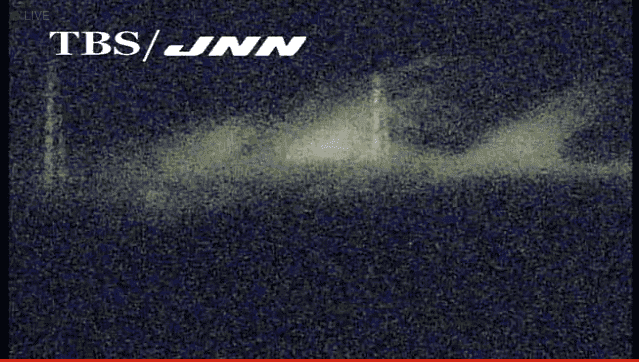

Wasn't there a set of photos showing heat more
concentrated in the center of reactor building 4?
Indicating the reactor was hot. Funny how this is
the explosion we don' have video of.
Guess the Toshiba re-shroud, doesn't work and we
will have to retire these reactors like the original
design said, after 30 years. I remember way back then
they said the concrete absorbs radiation over time and
cant be refitted, site reused. They also said they were
going to dry cask, and create a central storage location
in the shield, or something. Reptilian and sociopathic
right, sorry, no politics, just the facts now

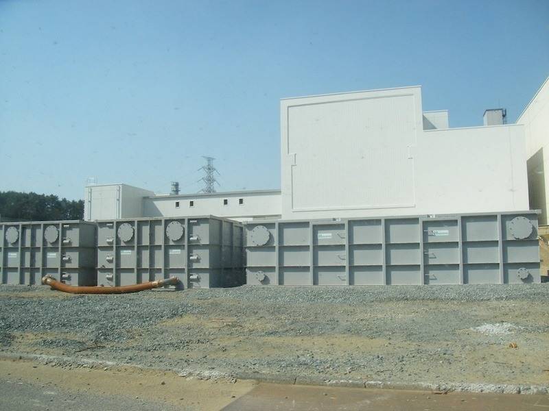

On the last page of this http://www.meti.go.jp/press/2011/04/20110419002/20110419002-2.pdf" the route to transfer the highly radio active water is shown.
This route is through the turbine halls 3 and 4 and the pipes are flexible plastic pipes with metallic spiral for support.
How does plastic hold up to high radiation? will it go brittle or loose strength?
Is it wise to route highly radioactive water through what is possibly a fairly uncontaminated area, in case a leak springs. There seems to be concern regarding the couplings as they tied down and double wrapped as added precaution.

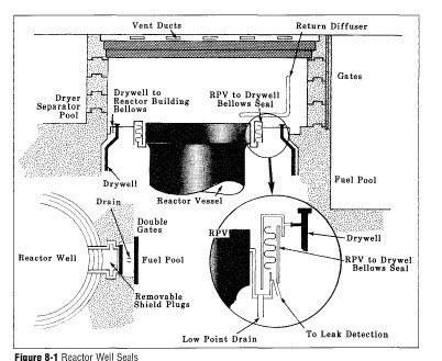

From Cainnech's post #4653:
https://www.physicsforums.com/showpost.php?p=3262389&postcount=4653
"TEPCO suspects that the water leaked from the RPV is leaking through the cracks in the wall that separates the Reactor 3 turbine building and the Reactor 4 turbine building."
