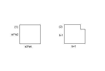

I came across something from the higher classes of math and I tried to prove it:
What do you call this kind of reasoning. Can it be called a proof? Or is this kind of like a pseudo-proof? I've never seen any proofs actually. Is my reasoning correct or is it too ugly to look at?
[The illustrations are in the figure.png file.]
Prove that adding 1 to the product of four following natural numbers results in a square number.
Example: 1*2*3*4+1 = 25 or 5*6*7*8+1 = 1681
[tex]b^2 = a_1*a_2*a_3*a_4+1[/tex]
[tex]b = \sqrt{a_1*a_2*a_3*a_4+1}[/tex]
[tex]b^2-1 = a_1*a_2*a_3*a_4[/tex]
If ([tex]a_1*a_2*a_3*a_4[/tex]) was to be a square number without adding the one (+1), we could illustrate the product of multiplication with a geometrical square [Figure
#1]. But since we need to add (+1), it means that the square is incomplete (look at [Figure #2]).
The incomplete square in [Figure #2] is calculated to b^2-1 (look at the previous definitions of (b)). How would we calculate the area like in [Figure #1]? We factorize/break out (sorry, English is not my native tongue and I don't know the English math terminology):[tex]\frac{b^2-1}{b-1}[/tex] = (b+1) turns into [tex](b+1)(b-1) = b^2-1[/tex]Now we see that it is incomplete (if you look at Fig. #2).
What is taken to make [Figure #2] incomplete? We look at the difference:
[tex](b^2)-(b^2-1) = -1[/tex]If we neutralize it with (+1), we get a square number:
[tex]b^2-1+1 = b^2[/tex]
Besides, we know that adding +1 makes b^2 a square number (look at the third definition of b):
ABV

By writing b2 = a1a2a3a4 + 1, you're assuming that you get a square, which is what you want to establish. Further, you didn't use the fact that you have 4 consecutive natural numbers anywhere in your proof.
I would start over.
What you want to do is show that the following expression
n*(n+1)*(n+2)*(n+3) + 1
is a perfect square.
Hint: re-write it as [n(n+3)]*[(n+1)(n+2)] + 1, and try to expand the things inside the square brackets. Notice anything interesting?

We do not know if b2 is a square number or not. We need to prove that. What you have done, actually, is to assume that it's a square number, and jump to the final conclusion that you've proven it. (Which may take only 2 lines, but you've made it like a page long.). Well, no, you haven'y proven anything yet.
Since b (in your proof) is a real number, b2 can be any number, say:
[tex]b = \sqrt{5} \Rightarrow b ^ 2 = 5[/tex], so, now, your b2 is obviously not a square number.
Can you get this? :)
If you want to re-prove it, see morphism's comment. The product of 4 consecutive integer is n(n + 1)(n + 2)(n + 3), where n is any natural number. Adding 1 to it, gives: n(n + 1)(n + 2)(n + 3) + 1, now, if you can make it something like (...)2, then you are done. :)
