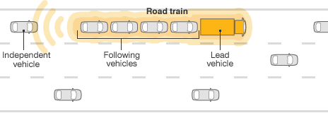

http://news.bbc.co.uk/2/hi/technology/8349923.stm

I get your point, but it obviously can't work in the real world where we have human drivers with human limitations (the fore mentioned "reaction time"). Your point would work only under certain conditions...such as already existing trains, as well as the upcoming "road trains", both applications where the human factor is eliminated.
However, on current roads with current variables and human drivers, recommending a fixed following distance would be very foolish, unless you enjoy death.
Ok not a fixed distance but would it make sense to increase follow distance with an increase in speed NOT TO MENTION IN PROPORTION to speed as German lawmakers suggest?
