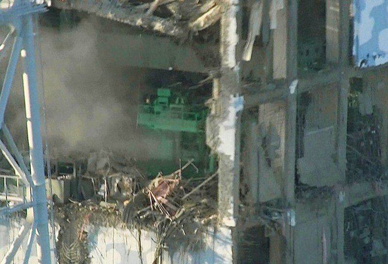

Whilst I don't believe anyone can be sure, the tongue of material coming out of the large hole has the appearance of a molten metal-slag mix. Once it started leaking from the building it was exposed to convective cooling which solidified the "crust". Was it you who first suggested this?
In this thread, perhaps. I haven't seen or read any other comments about that "tongue", but it caught my eye for sure.
AtomicWombat said:
I'm less convinced about the red dots. However I am far more concerned about reactor 3 than the authorities. I suspect the steam cloud is coming from what remains of the reactor core. The explosion last Monday was directed strongly vertically suggesting to me it originated from deep within the containment structure. It clearly carried substantial solid material to a height of 400-500 metres. Whilst I can't be sure this may have been due to a melt-down of the fuel rods in reactor 3. They melted through the reactor floor (1500 Celsius) and fell into the flooded "dry-well" below. This triggered a large steam- zirconium-water-hydrogen explosion. I suspected this not only blew the concrete top off the containment, it also blew most of the reactor contents out of the reactor.
These are my best visual interpretations based on what I know of the reactor chemistry (I'm a former chemical engineer) and careful observations. In the absence of honesty from TEPCO and the Japanese government what else can you do?
I can't be sure if the hole is at the bottom leel of the SFP, or perhaps, the floor level just below the bottom level of the pool (ie, perhaps hot slag went down, into a pump room, then out the wall). Either way, a big hole in that location is very bad, as is the wind shift.
The debris hanging from the base of the hole in Unit 4's secondary containment looks like insulation. The red parts look like they are painted red - not glowing red.
The hole appears to be above the floor of the concrete structure of the reactor building.
The flow of plumes at that level will be directed by local currents. The plants sit east of a hill. The atmosphere above generally blows from west to east, but the jet stream can kink, blowing anyway from N to S, and perhaps westward (or SW or NW), but it predominantly moves from W to E at that latitude ~ 32 N.

I keep looking at images. It is hard to know for sure, but I believe this is probably unit 4
and it looks like the access tunnel to the crane lift may in fact be in the back of the building. In retrospect, that probably makes more sense as the fuel rod assemblies would need to come in on a truck. If that is the case, the my orientation of the diagram is bass-ackwards.
I find Astronuc's interpretation of a sheet of insulation hanging out the hole hard to refute, and I certainly agree the red dots are not clearly something "hot". Also, on reflection, I suspect that had a pile of hot nuclear material slagged out the side of the building, there would be a lot more residual heat and smoke.
All reasons for a little optimism for a change. Let's hope that the SFP is intact and that they can get more water to it somehow.
I'm happy to be proven wrong on this and I can only say the tongue looks like corium lava.
I disagree completely. Fukushima 1 units 2, 3 & 4 all have a clear ridge around the external building that denotes the boundary between the floor level - the level of the reactor "mouth" and the top of the spent fuel pool - and the concrete containment and other concrete support. The hole is clearly below this level.
  • #332
Yeah - on review, it does seem to be the first panel below the floor level. I also appears to be above several louvered areas, which I would expect are heat removal or ventilation systems, though the louvered areas seem to be in a build between the containment and the photographer.
That was a panel that blew out, but it does not appear to be concrete. The actual construction seems somewhat different than the published images (artists rendering) of the Mk I containment. I'd like to see a close up of the area.

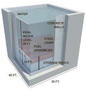

Unfortunately for now I'll have to match your BOTE calculation with my own BOTE calculation.
From:
http://allthingsnuclear.org/post/385...r-core-cooling
Assume the fuel heat is equivalent to a boil-off rate of 50 gal/min (approx 10-20 days after removal from reactor).
This is equivalent to about 8 MW.
Using the stefan-Boltzman Law: Power = 5.67E−8*T^4, one square metre of Zironium will give off about 1.15 MW of heat (as a black body) at its melting T = 2128K. That requires about 8/1.15 say 6 m^2 of unobstructed radiation area to dissipate.
But we don't need to reach 2128K, we only need to reach 1500 K where zirconium reacts exothermically in air or steam. (Note zirconium is protected by a passivating layer that breaks down at this temperature.) The oxygen-Zr reaction gives off 12MJ/kg; the H2O-Zr reaction gives off 5.8MJ/kg.

But do I misunderstand? The core fuel in Unit 4 was in the SFP, not in the core. Certainly there must be something fundamentally different between the SFP of Units 4, 5, and 6 if only Unit 4 exploded.

Just the same problem that they've been having with all the reactors - the buildings were confined and allowed hydrogen to build up in them:
The Unit 4 pool lost water - it should have taken days according to NEI, but there must have been a leak in the pool or something - ditto the #3 pool, but #3 is already open to the air from the previous hydrogen explosion, so no hydrogen buildup no matter what it does.
From the thermometers in the #5 and 6 pools, apparently there is still water in there.
To me it looks like insulation as well.
Also, keep in mind that the temperature of the SFP was reported to be 84°C on the 15th. Hard to imagine that it would heat up to the several 1000°C required for melting in just one day. Even if there was no water and we were talking about unspent fuel rods. Furthermore radiation would have spread much farther if a molten core would just be flowing out of a building.

I would expect that it is water being added to the spent fuel pools. As we understand it, the containment is intact, so flooding the floor would only affect the spent fuel pools (SFPs), and they are probably depositing that in the SFPs.
If there is a breach between the SFP an containment, that's a different story altogether. There is a fuel transfer canal between containment and SFP. That is how fuel is transferred from the containment to SFP. The fuel is kept underwater.
If there is a breach (leak) in the gate(s) between SFP and containment, then the water could leak out of SFP into containment. I don't know that is the case though.
Also, if there was a breach in the SFP (I'm not say there is, because I just don't know), then the cooling water could leak out in addition to evaporating.

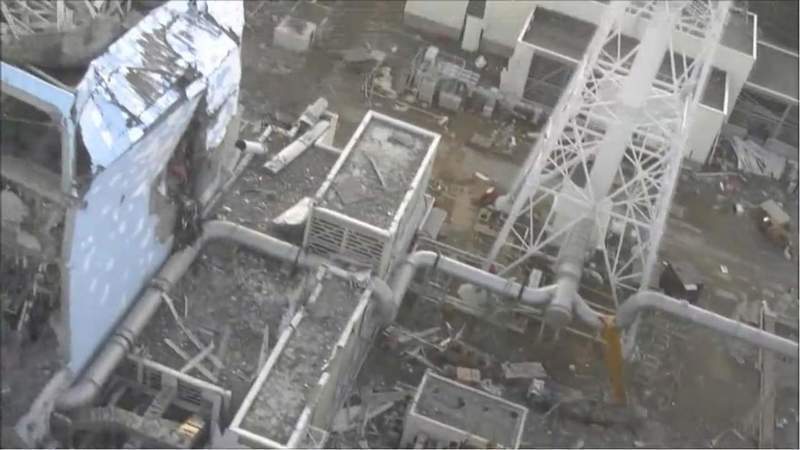

The reports are indicating that hydrogen escaping into the outer shell of the reactor building caused the explosion which blew off the top of reactor building 1. The steel frame atop the reactor building 1 is visible to the right in the photo at (http://www.greenpeace.org/international/ReSizes/OriginalWatermarked/Global/international/photos/nuclear/2011/digitalglobe-flickr-Fukushima-Japan.jpg) (source reliability considered but the photo does not appear to have been edited).
Reactor building 4 to the left of the picture reportedly suffered from two fires, at least one of which was attributed to lube oil combustion. However in the photo the majority of the lower and upper east facing wall of the building appears to be blown out between framing, while the roof appears to remain in place, and as the photo in post 305 shows, much of the cladding wall of the upper north facing wall of building 4 remains. That result would appear to indicate damage other than form a lube oil fire, and from a different sort of explosion than damaged building 1.
If the building 4 explosion were due to hydrogen from the spent fuel pool or from steam venting from the containment rising why would the roof and top wall cladding remain while the lower east facing wall appears to be blown out? The JAIF report for 1600 hours on March 17 suggests Unit 4 containment integrity is not damaged. Do the remains of building 4 suggest an explosion lower down in the containment and a major breach of the containment (or in the torus if it is not considered part of the containment)? Or is there a more likely explanation for the pattern of building 4 damage?
