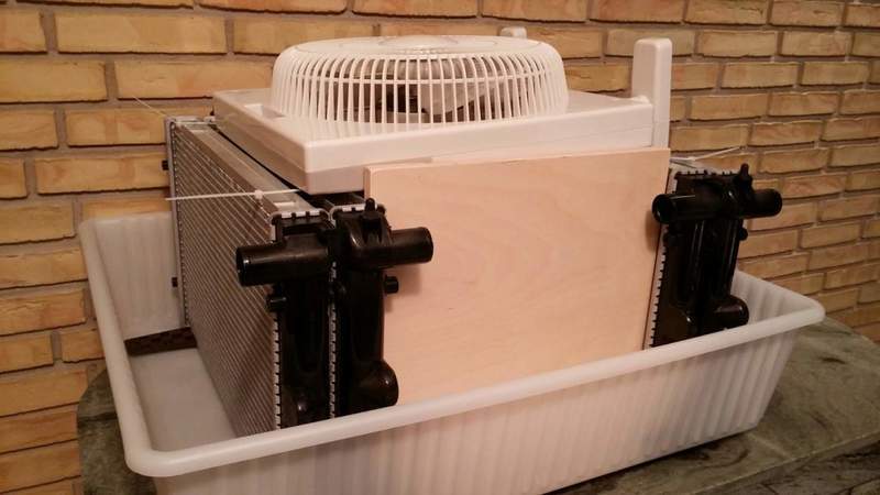

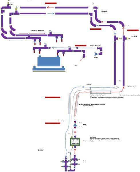

Picture1: (two blue boxes) I bought two 316 steal heat exchangers second hand and I will use them in parallel to lower resistance. Arrows are 40 mm pvc flex hoses. It will also have 4 thermometers and a flow meter. The manifold at the bottom of the picture distributes from 40 mm pvc pipes to 4 x 25mm pvc hoses for the car radiators. A long the pipes the purple Ts with yellow studs are for letting air and water out, they represent the highest point over the garage and the lowest point by the drive way. The green square is the expansion tank and it will change position together with the pump to right before the water/water heat exchangers.

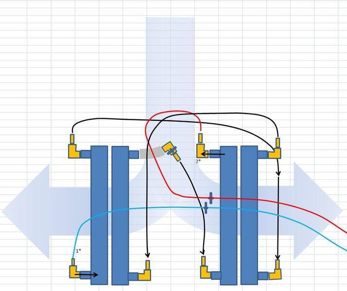

Picture2: Mockup. The system will have 4 fans and 16 car radiators distributed in 4 IKEA bed drawers.
Picture3: Hot air from the top of the loft is pushed through the radiators. The studs point upward to let more air pass automatically.

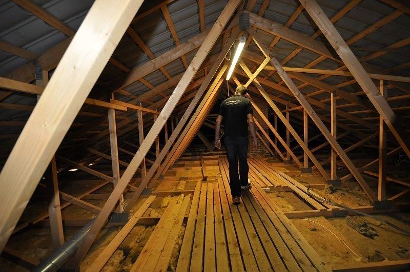

Picture4: The loft with no insulation in the roof.

Picture one: too small, can't read text.
Picture two/three: I would recommend having all the radiators in parallel. Overall mass airflow will be higher as the CSA will be doubled (air fans don't like constrictions) and the temperature differential at each radiator will be greater. Make sure there are no air gaps, expanding foam/duct tape etc will do.
Picture four; seal the air gaps at the eaves (can see light coming through on the left). I don't know about your house specifically but in my experience significant drafts appear on hot days due to the buoyancy of the hot air in the roof space. You may have noticed it when you open the manhole on a hot (relatively still) day?

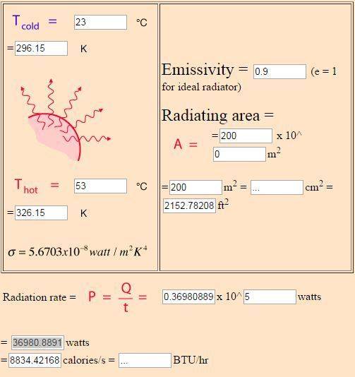

I just calculated that the net radiation from my roof to the outside environment is 37.000 W.
To me it indicates that the throughput in the loft air is very high, and the 37.000 W does not include conduction and convection.
I used Georgia State university's online Radiation Calculator .
Please see the attached screen dump.
The calculation was done with a temperature difference that I meassured daily through May, June and July. August was rainy. Below are the assumptions I used to calculate the result:

At equilibrium at Ton the sunny 100 m2 roff metal might be 50° C, the loft air/loft floor might be 30 C, and that gives a net radiation into the loft of 12.500 W using the same calculator as before. (http://hyperphysics.phy-astr.gsu.edu/hbase/thermo/stefan.html#c3)
Elegysix made this nice calculation (thanks), and I think he is right and wrong.
elegysix said:
I really think 10,000 W is far too high power for heating the loft air,
Supposing V is 1,000 m3, and 10,000 W went into heating your loft, your loft would be heating at a rate of 10kW/(1.09*1,000) =~0.009K/s, at a temp of ~53C.
Isn't this the rate you would expect in Space orbiting the Earth going from shadow and into the sun: 0.009K/s? Disaster and Science Fiction movies have many good examples of the sun appearing or suddon cold environments with little radiating heat. The Suns power is only about 50% greater in Space (locally) than on Earths surface.
But the rate of 0.009K/s is not un-natural.
The reason why we don't see this rate in anybodys roof on Earth is because the environment everywhere here is a great heat capacitor that absorbs/emits energy fast and thereby evens out any difference in temperature by radiation (not to mention conduction).
Energy is generally exchanged quickly, we just don't see it because usually the net transportation equals zero.
I might be missing something?

This shows me that a substantial fraction of the heat will radiate from the sunny roof to the loft.
If I find the time :confused: i will make the right temperature measurements and estimates and an illustrated spreadsheet model with equilibriums Toff+Ton, sunny and shadow roofs, air, loft materials, car radiators, air streams, and arrows of radiation, conduction, and convection.

You can't neglect Stephan-Boltzmann. The roof surface is one hundred times bigger than the human body in Space and hence the temperature that I have measured daily have showed me that at temperature Toff (Equilibrium with pool heating off) the roof radiates ≈1.100.000 W into the loft(net is still zero) as well as 37.000 W out of the loft (net loss to the environment).
When temperature Ton (Equilibrium with pool heating on) is reached the sunny roof temperature drops to maybe 50° C (the shadow roof may be much colder e.g. Ton). The point here is that now at Ton) the loss to the outside environment is much lower, and this difference is the heat that is going into the swimming pool.
What happens inside the roof is not important, as long as I know that the heat in there is moving around. Here radiation prooved simpler to estimate than forced convection. What really interests me is the difference in the roofs loss to the environment between Toff and Ton.
The difference in roof surface temperature indicates with Stefan-Boltzmann that energy is going into the pool.
Most of you agreed that the loft temperature would drop quickly and I argued that this is translated into a lower roof temperature, much lower loss of energy to the outside environment and a substantial amount of heat going into the pool instead.
Thanks for the input about the loft. Until a week ago I had nothing but a gut feeling.I am still interested in hints about car radiator physics.
the net power radiated into the loft is P=εσA(Troof4-Tloft4)
if Troof= 50 C, Tloft=30 C, ε=.9, A=200 m2,
then P = 25 kW.
In other words, to keep the loft's temperature at 30 C, the sum of power lost and power sent to the pool must be 25 kW.

Actual results:
The car radiators ended up giving 13.000 Watts of heat to the swimming pool and today the pool temperature was 32 C / 90 F. (The last ten days the air has been 15 C / 59 F during nights and 25 C / 77 F during the day and sunny)
When I use 1 Joule of energy I get 30 Joules back; k=30. A normal heat pump only has k=4 or 5. (The eight fans and the two pumps use 436 watts.)
I build the system with 24 car radiators and they produce 540 Watts each - and 540 Watts is the answer to my original question in this thread.
Dimensions of water pipes, pumps and flow:
50 meters of 40 mm pvc pipes distributed to 4 x 10 meters of 25 mm pvc tubes run by 100 Watts of pump power and that sends 1660 Liters of water back and forth every hour with a temperature increase of 5 or 6 degrees Celcius.
People may ask, "why didn't you just use regular solar water heating collector panels". Well my wife is a designer, and she said panels would look bad on the roof - end of discussion. Also i didn't like the idea of installing a heat pump, that would be expensive and noisy to run.
I think the system is a success, it was fun to build and it is fun to have, but its 400 components did cost 4000 dollars to buy and it will take 200 dollars to operate per year. Alternatively a heat pump would cost 2000-3000 dollars to buy and 1000 dollars to operate per year. (Danish prices).
I love watching free energy going into my pool.
