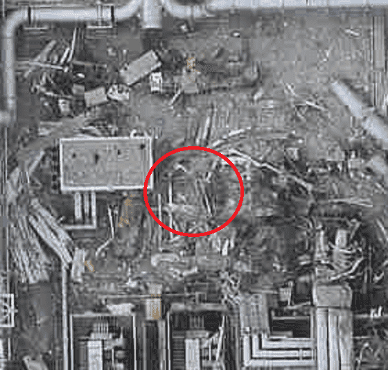

  • #7,176
razzz said:
These roof panels that are long and narrow and overlapping or interlocking when attached to the joists and ribbing that make up the roof ...
You seem to be referring to a layer of ribbed sheet metal (aluminum?) strips that sits over the steel framework. Those strips look like bits of white fettucini in the aerial photos (some 8 meters long and less than 1 meter wide), and are scattered all over the place. a few of them are still attached to the steel frame of #4.
Above that sheet metal layer there seems to be a dark grey layer of concrete and/or tarmac. In the best photos of #4 one can see some ribbing on it too, possibly a negative cast of the ribbing on the metal sheets. That layer presumably is reinforced with rebar or wire mesh, because in #4 a chunk some 15-20 meters across was thrown up in the air, then sliced though the steel beams next to the north wall, and is still hanging there in one piece.
razzz said:
Unit 4 looks like the blast (type??) came from the lower floors so didn't disengage the entire roof like a 'normal' hydrogen explosion would and even forced the parapet and its associated pivoting wall inward during the blast just pushing or sliding the roof section that remained inward until it folded the framework.
In #4 the entire concrete/tamac layer and almost all the metal sheets of the roof were blasted away. Part of the explosion indeed appears to have occurred in the 4th floor (below the service floor), but the only communications between those floors are the elevator shaft and four narrow stairwells at the corners. That is quite enough for the H2 to flow between floors, but hardly enough to transmit the explosion with such a force. Moreover the service floor slab of #4 does not appear to have been breached or even cracked (unlike that of #3).
I still cannot quite understand what hapened to the top of the north wall of #4. Its exterior paint seems to have been scraped down, and its top edge was pushed southwards (i.e. inwards) by several meters. I thought about the middle parts of the pillars being pushed out by the explosion and causing the tops to pivot inwards; but there does not seem to be anything in that location that could have served as the pivot, and I cannot see how the explosion could have pushed the middle of the pillars out without also pushing the top.
My best theory so far is that the slab of concrete/tarmac on the roof, after being lifted by the explosion, behaved like an airfoil and fell diagonally rather than straight down (as a playing card will do if you drop it at an angle). Part of it hit the roof steelwork near the north wall; after slicing thhrough the roof beams it crashed into the north pillars near the middle, breaking them at that height and pushing them out. The other part of the slab fell over the top edge of the wall; being tilted, it slid northwards and down over that edge, leaving the scrape marks and pushing the edge down but southwards. This chunk of the roof slab should now be lying among the rubble and ruined buildings at the feet of the north wall.
Since buildings #3 and #4 seem to be very similar, I would expect the roof of #3 to behave in a similar way. Namely the concrete/tarmac layer probably was lifted as one or more large "flakes", rather than pulverized. (However the explosion of #3 was more forceful and so the flakes may have been smaller than the mega-flake of #4.) Once in the air, those broad but thin flakes may fall obliquely rather than straightdown due to aerodynamic effects. Does this match the observations?
