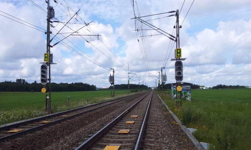

Hello dear PF-members! :shy:
I'm looking for some appropriate formula which could be utilized to calculate the magnetic field density in a straight high voltage AC mere cable. If you're more into the details of why I may ask this - I'm working with the railway maintenance and got interested in how a high voltage cable relates in a physical perspective besides of what I already know - that it carries 16 kV of fatal power.
Besides the magnetic field density, I'd like to know if the inductance can be calculated and if the formula differs especially much if it's DC instead of AC? Also how far out the magnetic field (inductance) stretches out from the cable?
I know some math so understanding such thing wouldn't be awfully hard I hope :biggrin: ..
What I know is this
16 000 V
50 Hz
(The length of the cable could be considered to be of optional length since it's railway cables)
I found this formula but it seems to only be for the magnetic field density (Tesla)
B=μ*(NI/l)
Thank you for your help! :smile:

I think you are misusing the terms slightly.
Inductance is a property of a conductor (we call it L when talking about inductors in circuit classes) and, as far as I know, it is a scalar quantity (unless in certain problems it needs to be defined otherwise perhaps?), meaning that it has nothing to do with space, ie inductance does not "stretch far out". It depends upon the physical and geometrical characteristics of the cable and unless you know those it'd be hard to calculate it. however it seems this is not what you are asking.
The magnetic fiend generated by a cable is depended by the current passing through it, and not voltage, which means you'd need an estimate of the currents in such a cable in order to find B.
In this case the cables we could assume that the cables are very long, ie infinite for the purpose of calculations, and the following formula can be used B =μI/2πR, where μ is the magnetic permeability of air, R the distance from the cable and I the current flowing inside. I believe the formula is the same for AC or DC currents (AC current will create an alternating field and DC a constant one).
have a look at this http://www.phys.uri.edu/~gerhard/PHY204/tsl216.pdf

Thank you very much! Yes, I suppose inductance wasn't what I asked for. Yes, AC creates and alternating current which I have seen because in certain high voltage cables there is around 16 Hz. And an app on my phone was able to (for fun) see how the magnetic field alternated. Common 60 Hz is too fast for the app to see and is thus registrated as it it was DC.
Anyway, now On topic - the forumla looks good. The values can be looked up (the resistance etc). I am on the phone now but I'll come back later for any results :p
Okey. By using the formula above with various values (5,5 meters and 0,1 meters) of the radius I got:
(B =μI/2πR)
B = μ*600/2π*5,5 = 2,18×10-5 T
B = μ*600/2π*0,1 = 7,53910-3 T
Is this much? Especially the latter value of 0,1 m? o_O
Thx
Seems to me that there are two distinct conductors involved. The Rails below form one while the wire suspended above (contacted by the pantograph on the train) forms the other. The instantaneous current flowing through the train will flow in opposite directions in those conductors. The rails and catenary wires therefore form a virtual two conductor transmission line. The distant magnetic field due to the opposed currents in the two wire transmission line will tend to cancel while the magnetic field at the midpoint between will be twice the field due to the current in either conductor.
Now the complexity. The two rails are parallel conductors so you should model half the train current in each. The overhead wire is usually a pair of wires, the one above hanging in a catenary while the one below (contacted by the pantograph) is suspended from the catenary wire by different length straps so that it is close to level. The train current will be flowing in both those overhead “parallel” wires so you will need to apportion the current between them and calculate the field due to each since the radii from your point of interest will be different.
So to calculate the field at any particular point you must sum four fields due to the four currents at the four different radii. Polarity is important. That field will only be present between the pantograph of the traction unit and the local supply connection to the line. There will be very little field beyond the train. Where power is fed from both directions the train current will be shared from ahead and behind which will effectively halve the current and the resultant field.
