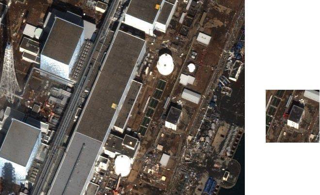

REACTOR ACCESS FLOOR LAYOUT?
Can anyone here add to or correct anything I may have wrong here, please. These are annotated images from drone fly over posted earlier by Fred with what I "think" may be the layout of the reactor access level floors. As can be seen, this will substantially affect how the remainder of the damages might be interpreted.
Blue Rectangle = Pools
Orange Ovals, Circles = Dry Well Cap and approximate positon of Dry Well Plug on floor
Red Rectangle = Building Footprint
Green Rectangle = Lift Shaft
Important points that I am not certain about some basic layout aspects:
1) Are the floor layouts exactly the same in the two buildings?
2) Is there indeed a smaller pool off the side of the SFP between the SFP and Lift Shaft?
Note that the Dry Well Cap has been removed from Reactor 4 but (I believe) would still be in place on Reactor 3. I use it as a relative gauge of the size of where the footprint of the Dry Well Plug would have to be on the floor. Thanks.

Your annotations looks spoton and are briliant to nail some facts.

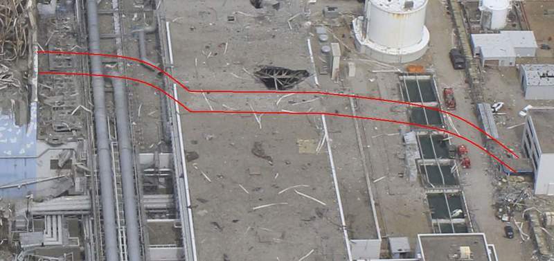

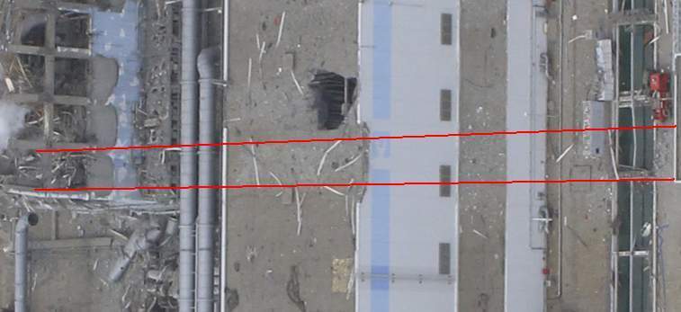

From a pdf provided on the board http://ompldr.org/vN3VhMQ I extracted some layout of the improved Mk-1 used in Fukushima Unit 4 (for sure) and very likely on 2 and 3
It did not quite fit the look of the building we have in fujushima, So I figured (made the hypothesis) that the japanese sightly moded the upper level to make a nice rectangular building and got rid of some lower space.
(japanese design :red line vs blue) and got rid of some space on the (east wall)
based on my speculation i just corrected the perspective of the picture only based on external square structure and height of the 2 top floor..

Fred:
This is excellent. We can now start to look at all the pictures again and make more informed assessments of the damages and possible mechanisms. But at a glance, on the south face of Bldg 4, the blown out panel(s) ARE NOT the area of the SFP, and they are BELOW the level of the reactor access floor, where, in Bldg 1 for sure and Bldg 3 with high probability, most of the hydrogen gas accumulated before the explosion. And the explosion at Bldg 4 DID NOT come from the reactor vessel or primary drywell containment. Hmmmm. . .
