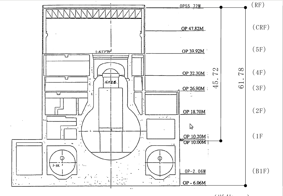

Can someone please be so kind and repost the link to the large cross-sectional plan of the nuclear reactor that was posted some time ago, not the GE handout - I tried very hard and cannot find it
  • #3,682
this one? http://fukushimafaq.wikispaces.com/Reactor+Blueprints
yes - you are a star - thanks

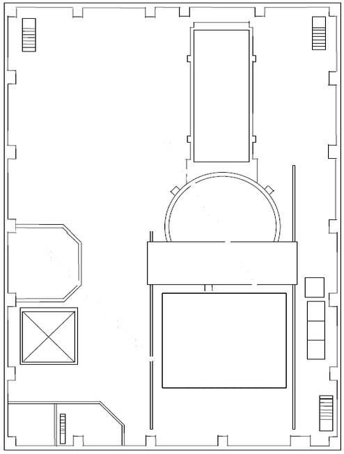

AntonL said:
Fuel in pool: 1331 spent fuel assemblies and 204 brand new assembles and some of them simply gone critical.
I already can hear Gunderson reporting that unit 4 is an open air reactor.
However let's analyse SPF 4
Capacity = 1425 m3 http://www.nisa.meti.go.jp/english/files/en20110406-1-1.pdf"
Decay Heat:
2000kW for spent fuel from unloaded reactor last operation 29 Nov 2010 (can be calculated)
+ 400kW long term stored spent fuel (estimated on the high side)
2400kW total
Assuming SPF4 was at 30oC
To raise 1425m3 by 70oC using 2.4MW it would take 48 hours
so SPF 4 has started to boil somewhere between March 13 afternoon to March 14 morning.
The pool is about 11 metres deep,
so to boil away 1 metre or 1425/11= 129.5m3 of water using a 2.4MW heater 33.8 hours
I cannot find the detail drawing that was posted here before to confirm the depth so I took depth of SPF 7
From earthquake (3pm 11/3) to unit 4 explosion (6am 15/3) if I can calculate correctly are 87 hours,
thus about (87-48)/33.8 = 1.2 metres of water would have boiled away at time of explosion.
that is the 4 metre fuel rods have 5.8m water covering them -
so where does the Hydrogen come from??
Helicopter crews on 17 March reported spotting water in SPF4 thus they concentrated on
dropping water on unit 3 - proof that there is ample water in the pool.
Spraying water into unit 4 was only started on March 20 at 9:40 thus
at time of explosion 6am 15/3 water level -1.2m
10am 20/3 114 hours later a further level drop of 3.4 metres due to boiling
thus when water spraying started on 20March the level was down 4.6 mtres
excluding leakage or spillage, this leaves the 4 metre fuel rods 2 metres under water.
Tepco set their priorities correctly and started spraying water at the right time.
http://www.nirs.org/reactorwatch/accidents/6-1_powerpoint.pdf" that the storage capacity of all fuel pools at Fukushima as 8310 fuel assemblies,
that is 1444 fuel assemblies can be stored at each units 2 to 5, based on SFP volume.
However, SPF4 had 1331+204 = 1535 fuel assemblies stored which is more than stated capacity! http://www.nisa.meti.go.jp/english/files/en20110406-1-1.pdf"
Therefore we can speculate that Tepco double layered at least two or three spent fuel racks,
this would explain the early exposure of fuel to air, hydrogen generation, fuel damage etc.
and we can speculate that two or three racks worth of spent fuel may be destroyed.
Debunk that. :biggrin:
Have I solved the hydrogen, spent fuel pool water mystery?
Now, should my calculation and speculation be proven true, Tepco needs to do a lot of explanation.
Let's please stop this discussion about "double layers" of fuel in the SFP. The depth of the fuel pool is about 40 ft and the height of a fuel assembly in the SFP racks is about 14 ft. Plant technical specifications require a minimum water level of about 20 ft above irradiated fuel in the SFP. This technical specification requirement could never be met if two fuel assembilies were stacked on top of each other. The very idea of such a thing would be impractical.
When a utility increases the capacity of the SFP, they do it by replacing the exisiting used fuel storage racks in the SFP with racks that allow the fuel to be placed closer together (higher density). The geometry is analyzed and possible change to the neutron absorber panels in the fuel racks are changed to preclude criticality of the assemblies in the SFP.
Back to loss of inventory in the U4 SFP: AntonL's boiloff calculations look pretty good. There probably was also several feet (maybe 3-4 ft total) of SFP inventory loss due to pool sloshing during the earthquake. However, the inventory boiloff plus the inventory loss from sloshing wouldn't explain uncovery of the irradiated fuel in the U4 SFP. It is possible that the earthquake caused a leak in the spent fuel pool (perhaps in the gate plugs that are removed when performing refueling operations between the reactor and the SFP). Such a leak, if large, would explain the additional inventory loss. However, the limited photos of the damage to the U4 reactor indicate that there was a VERY hot fire with explosions in the lower levels of the U4 reactor building. How H2 generation and ignition at the elevation of the U4 refuel floor caused this lower building destruction is beyond me.

Thanks for the link to blueprint for reactor building 1: http://fukushimafaq.wikispaces.com/Reactor+Blueprints
The reactor buildings of nos 2,3,4 are different: bigger in their horizontal dimensions and placed differently in respect to the corresponding turbine buildings.
Has anyone seen a blueprint for the no4 reactor building? How does the internal layout look like? Can one assume that 2,3,4 share a common internal layout?
Another thing: An annotation to picture http://i306.photobucket.com/albums/nn270/tcups/r735227_5964756.jpg of https://www.physicsforums.com/showpost.php?p=3196018&postcount=463 mentions thermal damage (from fire?) to the northside upper part of No.4. Has this been confirmed? To me that would explain that aspects of no4 damage that are bound inwards.
BTW Thanks to all contributing, have been reading here for the last week. And sorry if my question is noobish. I'm just an amateur trying to understand what's going on.
