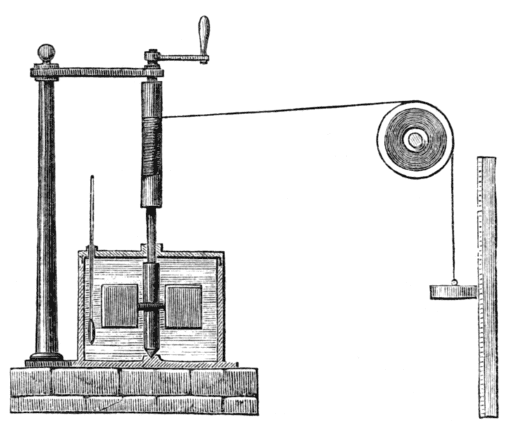

So I imagine the friction of the weight on the right heats that poll? Do you know the type of material used? And to what degree it can heat if repeated?

Thanks paisiello2!
No, the motion of the pallets in the water will heat up the water. There is no pole on the right hand side. Just a ruler to measure the height.
Thank you so much nasu, I was way off! haha That's interesting, but I assume it wouldn't heat the water much, even if it were repeated many times, right?
Thanks ModusPwnd, I see what you're saying. So all in all, it's not possible to create much heat simply using falling objects (unless we're talking of huge scales, like a meteors).

...but I assume it wouldn't heat the water much, even if it were repeated many times, right?
It's measurable.
