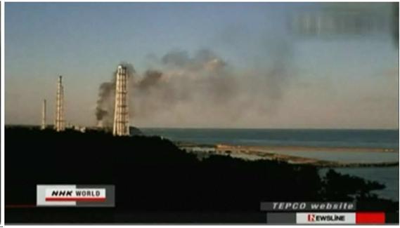

The helicopter fly over spent a lot of time looking at this debris field and at something on the top of this building. Curious.
What sort of blast might scatter spent fuel rods out of a SFP? One venting through the channel between the SFP and the reactor containment?
Astronuc: I hope you make it -- God speed and take care. Be sure to take a laptop and check in with us. Anyone else from your team likely to make the trip?
Since the blast was not likely below the spent fuel pool (pool structure would mitigate the blast force), the spent fuel elements due to their weight would not be ejected from the racks which are a tight fix due to seismic considerations.
